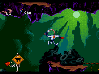

    Using VirtualDub's internal "TV" filter, I took a screenshot of two frames' worth of a still image and combined them into an animated .GIF:
    http://img28.imageshack.us/img28/7181/bobtest.gif
    The first pane is the whole image, the second pane is the "I" information, and the third is the "Q" information
    Due to the nature of the physical output resolution of these old consoles, doubling up the horizontal lines when deinterlacing doesn't technically degrade the final image quality... but for some reason, it's as though the color/chroma information isn't handled as effectively when deinterlacing. Here's another example, you can see how the color information jumps between frames (again, two still frames slowed to .5sec loop/playback):
    http://img837.imageshack.us/img837/6566/ewjbob.gif

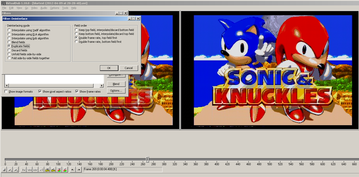

    See attached image, this is what happens when I don't process the file through AVIsynth when I open it in VDub.. Like I've said twice already, the same problem that this person has:
    https://forum.videohelp.com/threads/315260-Virtualdub-Deinterlace?p=1950529&viewfull=1#post1950529
Name:	without avisynth.png

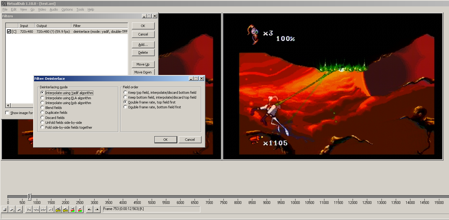

    Changed colorspace to YUY2, opened in VDUB without the avisynth string, see attached pics for output results. the .gif is two frames looped (mind you, the "Sonic & Knuckles" logo is supposed to bounce, I just wanted to make sure the lagging color information was visible)
    Using yadif in vdub doesn't result in anything better than the bob method (remember, I prefer bob BECAUSE the native pixels of the analog video stream are doubled-up to begin with... the Genesis outputs at 320x224(or 240) to begin with, which gets doubled to 640x448(or 480) within a 720x480 pane... yadif results in rounded edges and unnecessary smoothing, whereas bob replicates the video much more accurately)

    But VirtualDub's built-in bob and yadif will work OK if I use this script:
    DirectShowSource("J:\forum\AG-wolf\knux crop 3.avi")
    AssumeTFF()
    ConvertToRGB24(matrix="Rec601",interlaced=true)
  26. Originally Posted by sanlyn View Post
    Or ConvertToYUY2(interlaced=true). But since VirtualDub is going to work in RGB you might as well do the RGB conversion directly in AviSynth.
  27. Banned
    New York, US
    If I let VirtualDub make the RGB conversion, its bob and yadif don't work properly. This script produced problems the O.P. described:
    # AssumeTFF()
    # ConvertToRGB24(interlaced=true)
  28. I meant if you ConvertToYUY2(interlaced=true) an AviSynth and then let VirtualDub convert to RGB you would get the same thing as your ConvertToRGB(interlaced=true). And since VirtualDub is going to do it's filtering in RGB you might as well go straight to RGB in AviSynth.
    AG-Wolf, try this script:
    AviSource("yv12.avi")
    AssumeTFF()
    ConvertToYUY2(interlaced=true) #must use YUY2 to shift chroma down one line
    SeparateFields()
    Interleave(SelectEven(),SelectOdd().ChromaShift(l=1))
    PointResize(720,480) # or whatever resize you want, or nnedi3(field=1, dh=true)
    That takes care of most of your bouncing colors. You'll need ChromaShift() if you don't have it. I think capturing in YUY2 (or other 4:2:2 format) will eliminate this problem.
    These 4 images are 3x bicubic resize blowups of edge detail from the same frame, using the original input, bob(), yadif, and QTGMC.
    Okay, it's game time. The original is in the upper-left corner. Which of the other three do you think more accurately replicates the original?
    [Attachment 11896 - Click to enlarge]
    IMHO the upper-right is smearing details and edges, and even dulled the colors a bit. You can see these effects in the cross hatching in the image and the edges of the shoe. Beneath it, lower-right, I see less softening but some cross hatches are deformed in the lower corner, and the lower black edge of the shoe doesn't look like the others. I think the lower-left is almost exactly like the original. Now, panel, did the lower-left come from bob, yadif, or qtgmc?
