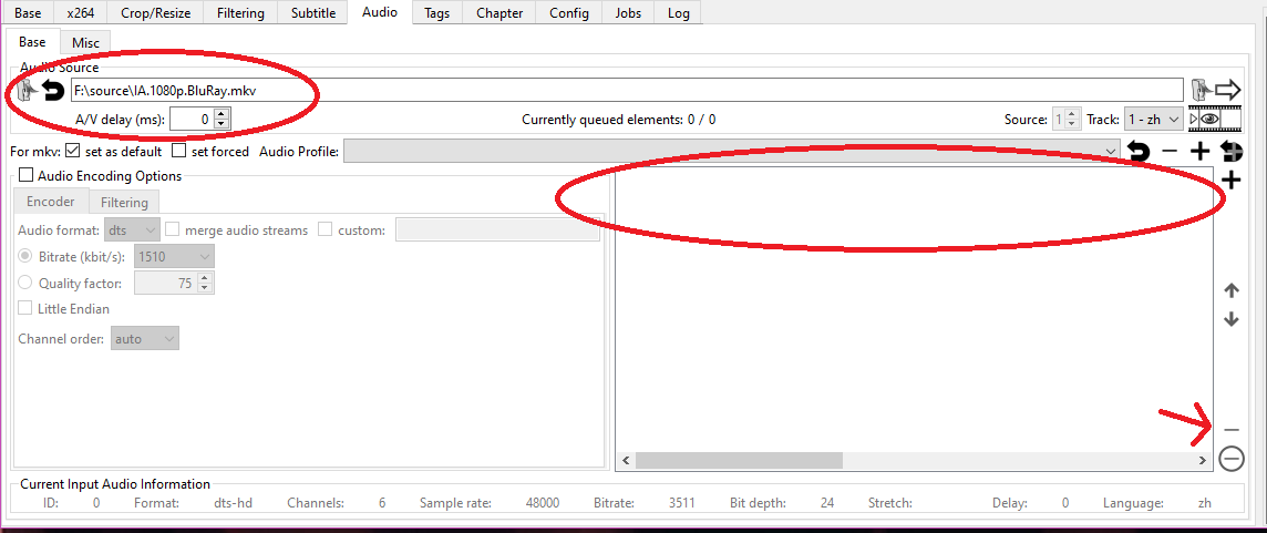

    My second issue involves the Audio tab. I want to add other audio files to be used. So under the Base sub-tab, in the Audio Source section, I use the file chooser to pick the audio file I want. Seems logical and great, it fills in the path to the file and it looks correct. Next, I assume that to add it into the queue box below, I just click the plus button as I usually do. Yes, it adds something to the queue, BUT it does NOT look like the audio file I chose because the path is completely different and points to the Main source file that was chosen in the original Base tab when loading up my makemkv file. The only other plus button on the Audio tab seems to point to loading a saved profile which is not what I want .... so I'm at a lost as to how to get it load the other audio files I want...

    Regarding the audio adding issue. It might be easier to show you the screen grabs.
    1. This is what the Audio tab looks like by default - after loading the source mkv and selecting the "auto add all" from the main tab.

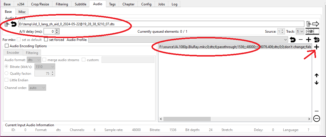

    2. Then I use the 'minus' button to remove the tracks from the queue since I want to use different ones.
    [Attachment 79347 - Click to enlarge]

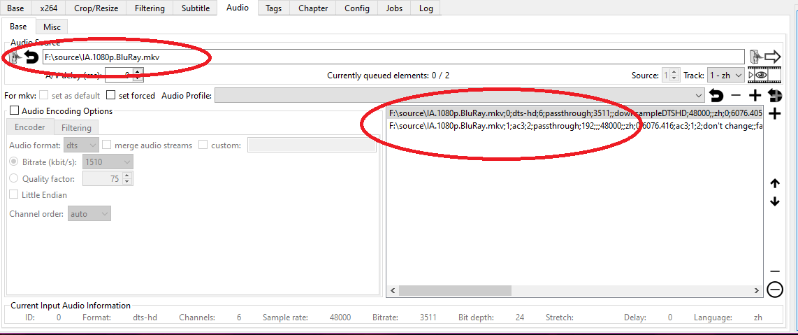

    3. Then I load the audio files I want using the file chooser, use the 'plus' button to add it to the queue, but it seems to not be doing that.
    [Attachment 79348 - Click to enlarge]
  10. Make sure to set Audio Processing to 'custom' is you are not using the auto handling modes,...
    From what I see of the Audio Queue entry, it looks correct,... 1st part of the queue points to the main source the audio should be added to.
    Cu Selur
    Jan 2024
    California
    Ah OK now I understand. Thanks!

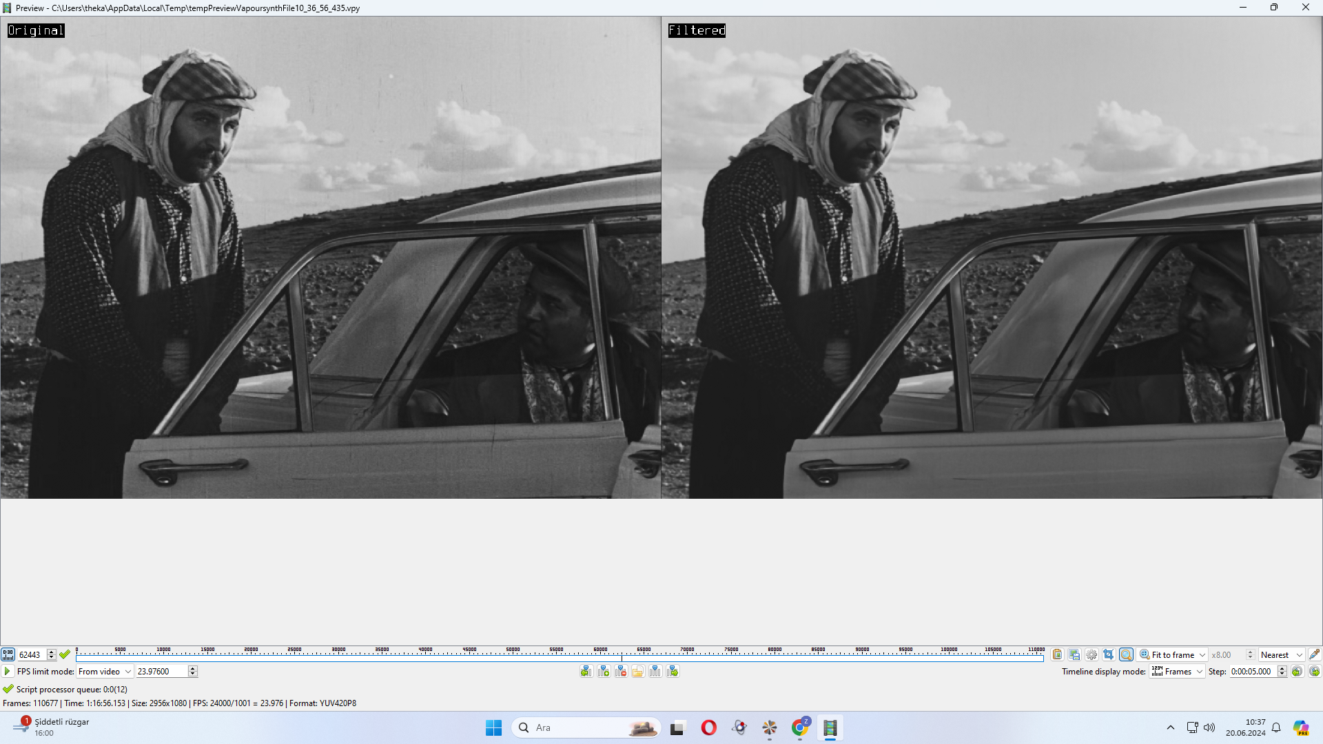

  23. selur What should I do to preserve the original colors?
    [Attachment 80044 - Click to enlarge]
  24. No clue what you are doing to change them in the first place,...
    Looking at the histogram after adding each filter might help to figure out what's happening and when.
  25. Originally Posted by Selur View Post
    First of all, every file without a filter is the same problem, the colors are different from the main file?
    avs script

    # Current color space: YUV420P8, bit depth: 8, resolution: 1478x1080, frame rate: 23.976fps, scanorder: progressive, yuv luminance scale: limited, matrix: 709, transfer: bt.709, primaries: bt.709
    # Loading D:\Hudutların Kanunu 1966 Criterion Collection Bluray 1080p H265 AC3 #turkseed\Hudutların Kanunu 1966 Criterion Collection Bluray 1080p H265 AC3 #turkseed.mkv using LWLibavSource
    clip = core.lsmas.LWLibavSource(source="D:/Hudutların Kanunu 1966 Criterion Collection Bluray 1080p H265 AC3 #turkseed/Hudutların Kanunu 1966 Criterion Collection Bluray 1080p H265 AC3 #turkseed.mkv", format="YUV420P8", stream_index=0, cache=0, prefer_hw=0)
    frame = clip.get_frame(0)
    # Setting detected color matrix (709).
    clip = core.std.SetFrameProps(clip=clip, _Matrix=1)
    # setting color transfer (709), if it is not set.
    if validate.transferIsInvalid(clip):
    clip = core.std.SetFrameProps(clip=clip, _Transfer=1)
    # setting color primaries info (to 709), if it is not set.
    if validate.primariesIsInvalid(clip):
    clip = core.std.SetFrameProps(clip=clip, _Primaries=1)
    # setting color range to TV (limited) range.
    clip = core.std.SetFrameProps(clip=clip, _ColorRange=1)
    # making sure frame rate is set to 23.976fps
    clip = core.std.AssumeFPS(clip=clip, fpsnum=24000, fpsden=1001)
    # making sure the detected scan type is set (detected: progressive)
    clip = core.std.SetFrameProps(clip=clip, _FieldBased=0) # progressive
    original = clip
    original = core.text.Text(clip=original,text="Original",scale =2,alignment=7)
    clip = core.text.Text(clip=clip,text="Filtered",scale=2,a lignment=7)
    stacked = core.std.StackHorizontal([original,clip])
    # set output frame rate to 23.976fps (progressive)
    stacked = core.std.AssumeFPS(clip=stacked, fpsnum=24000, fpsden=1001)
    # output
    stacked.set_output()
  26. First of all, every file without a filter is the same problem, the colors are different from the main file?
    What is the 'main file'?
    avs script
    That is not an Avisynth, but a Vapoursynth script. Also, the indention in script you posted are wrong.
    # setting color transfer (170), if it is not set.
      clip = core.std.SetFrameProps(clip=clip, _Transfer=6)
    # setting color primaries info (to 470), if it is not set.
      clip = core.std.SetFrameProps(clip=clip, _Primaries=5)
    I assume you used 'quote'- instead of 'code'-tags and this can be ignored.
    This script, show on both sides the same frame. The only difference between the frames is the label 'Original' vs. 'Filtered'.
    At this stage, any difference you see between the two sides (aside from the labels) is due to the lack of color stability depending on the viewing angle of your monitor.
    If this is the issue, setting 'Filtering->Vapoursynth->Misc->Preview->Split Compare View' to 'interleaved' while using 'Compare View' might help, since this way the 'Original' and the 'Filtered' version are interleaved.
    If the preview has different colors than you see them in side a media player, the problem might be due to wrong flags. (since your source is 8 bit it's not HDR, so color problems between SDR and HDR are not the problem)
    Cu Selur
  27. Originally Posted by Selur View Post
    avs script
    Cu Selur
    thank you
