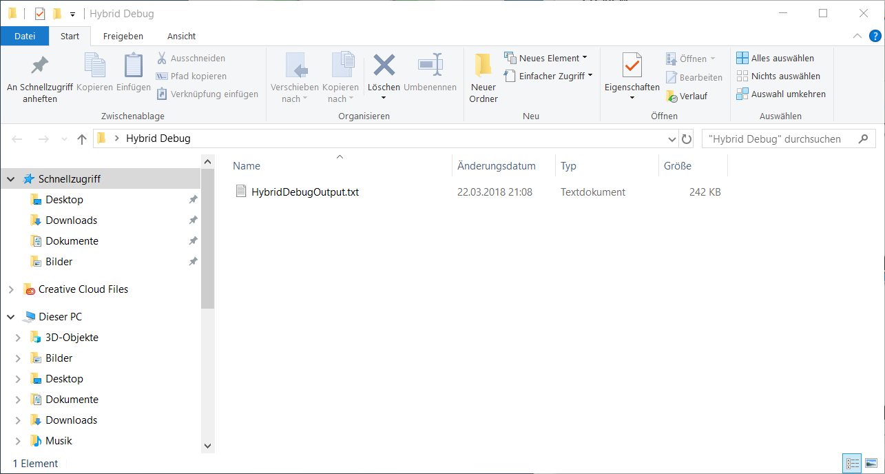

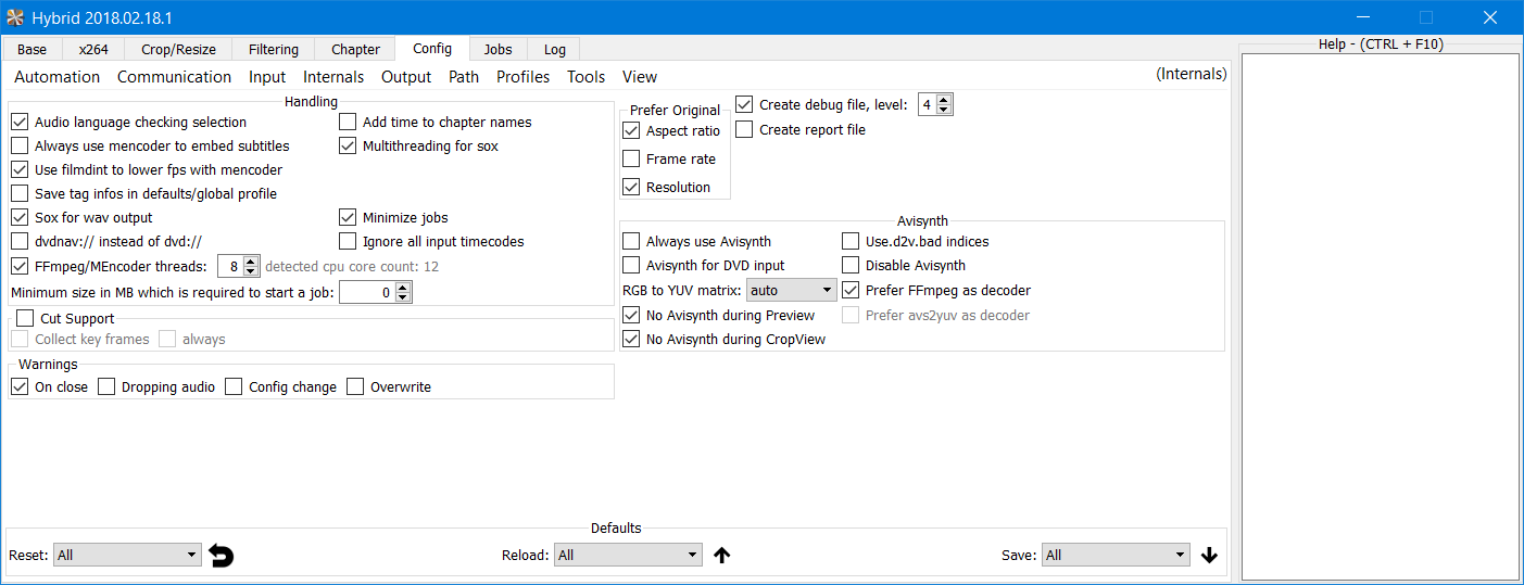

    It's exactly that thing what I have done. This is the debug output.
    [Attachment 45001 - Click to enlarge]
    [Attachment 45000 - Click to enlarge]
    [Attachment 45002 - Click to enlarge]

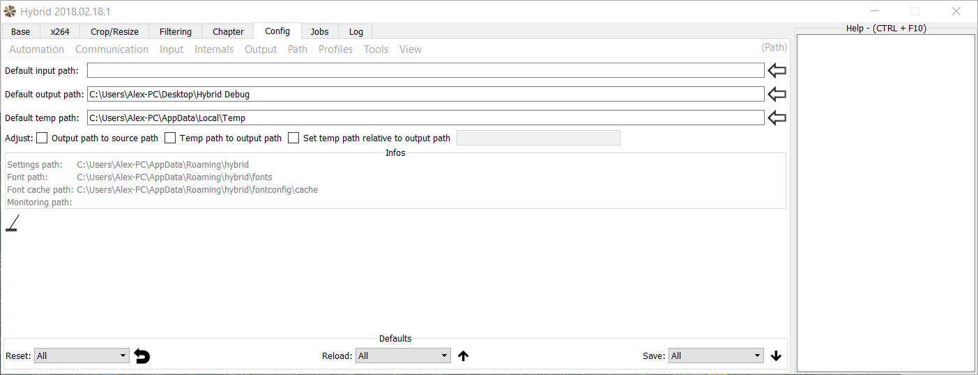

  2. Debug output will be created inside the output folder so once the output folder changed the location of where the debug output is being created changes.
    Your debug output contains the analysis of the source, but not the job creation. So you probably changed the output folder after that.
    Without a debug output of the job creation I can't really help.

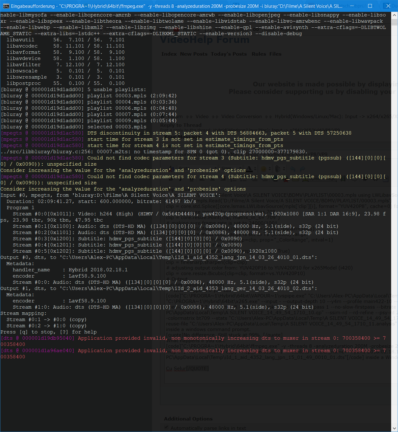

    Since the call looks fine to me, what happens when you call:
    "C:\PROGRA~1\Hybrid\64bit\ffmpeg.exe" -y -threads 8 -analyzeduration 200M -probesize 200M -i bluray:"D:\Filme\A Silent Voice\A SILENT VOICE" -playlist 3 -angle 0  -vn -sn -acodec copy -map_metadata -1 -metadata handler_name="Hybrid 2018.02.18.1" -map 0:1 -y -acodec copy -map_metadata -1 "C:\Users\Alex-PC\AppData\Local\Temp\iId_1_aid_4352_lang_jpn_14_03_26_4010_01.dts" -map 0:2 -y -acodec copy -map_metadata -1 "C:\Users\Alex-PC\AppData\Local\Temp\iId_2_aid_4353_lang_ger_14_03_26_4010_02.dts"
    inside a Windows Command Prompt?

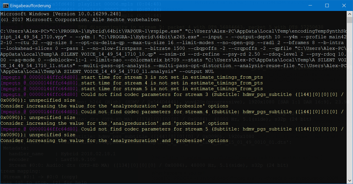

    Pastebin Link Command Prompt - Seems like to be an error.
    Image: Image
    [Attachment 45009 - Click to enlarge]
    -> What happens if you call:
    "C:\PROGRA~1\Hybrid\64bit\VAPOUR~1\vspipe.exe" "C:\Users\Alex-PC\AppData\Local\Temp\encodingTempSynthSkript_14_49_54_1710.vpy" - --y4m | "C:\PROGRA~1\Hybrid\64bit\x265.exe" --input - --output-depth 10 --y4m --profile main422-10 --ctu 32 --qg-size 8 --opt-cu-delta-qp --max-tu-size 16 --limit-modes --no-open-gop --radl 2 --bframes 8 --b-intra --lookahead-slices 0 --pass 1 --no-slow-firstpass --bitrate 1500 --cbqpoffs -2 --crqpoffs -2 --qpfile "C:\Users\Alex-PC\AppData\Local\Temp\A SILENT VOICE_14_49_54_1710_10.qp" --ssim-rd --rd-refine --psy-rd 2.50 --rdoq-level 2 --psy-rdoq 10.00 --aq-mode 0 --deblock=-1:-1 --limit-sao --colormatrix bt709 --stats "C:\Users\Alex-PC\AppData\Local\Temp\A SILENT VOICE_14_49_54_1710_11.stats" --multi-pass-opt-analysis --multi-pass-opt-distortion --analysis-reuse-file "C:\Users\Alex-PC\AppData\Local\Temp\A SILENT VOICE_14_49_54_1710_11.analysis" --output NUL
    inside a windows command prompt.
    Pastebin Link Command Prompt Image: Image
    [Attachment 45010 - Click to enlarge]

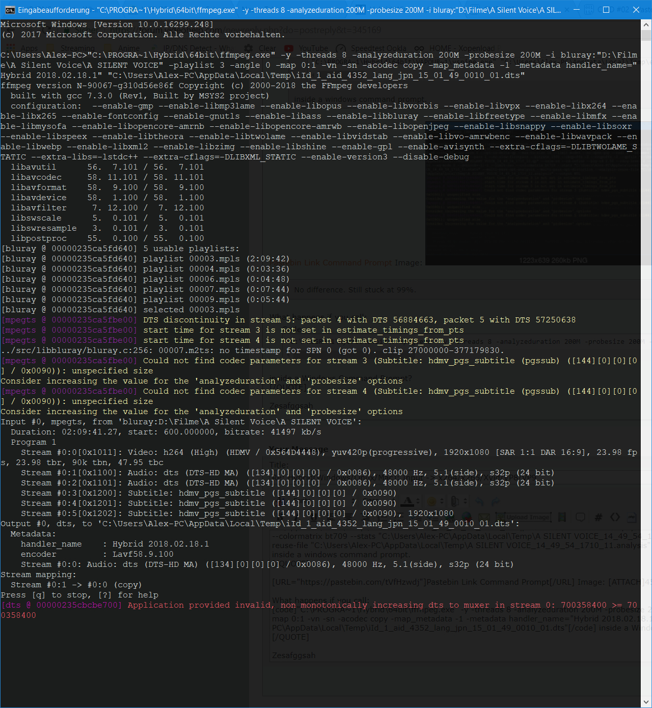

    "C:\PROGRA~1\Hybrid\64bit\ffmpeg.exe" -y -threads 8 -analyzeduration 200M -probesize 200M -i bluray:"D:\Filme\A Silent Voice\A SILENT VOICE" -playlist 3 -angle 0 -map 0:1 -vn -sn -acodec copy -map_metadata -1 -metadata handler_name="Hybrid 2018.02.18.1" "C:\Users\Alex-PC\AppData\Local\Temp\iId_1_aid_4352_lang_jpn_15_01_49_0010_01.dts"
    [Attachment 45011 - Click to enlarge]
    I hope it helps a little bit
  6. Code:
    Application provided invalid, non monotonically increasing dts to muxer in stream 0: 700358400 >= 700358400
    values seem to be the problem. with the audio. So seems like ffmpeg doesn't like the source. Remuxing to mkv before processing with Hybrid or disabling 'Config->Input->Extraction Prefer ffmpeg for extraction from transportstreams' seem to be the only solutions for handling the audio.
    Problem with the video is probably related to the same thing (sadly there is no way to increase the probesize&co here, which either way probably won't help), so solutions that come to mind are:
    a. try disabling 'Config->Vapoursynth->Input->Prefer LibAvSource over FFMpegSource2), this was ffmpegSource2 should be used.
    b. using for example DGDecNV in case you own it
    c. remux to mkv before processing with Hybrid
    Cu Selur
