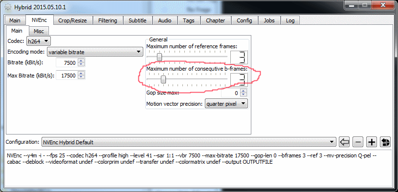

    Found the problem with the b-frames not getting enabled.

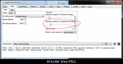

  9. Thanks for the test builds, there's good news and bad news: the good news is that all but one of those weird pop ups are gone. The bad news is that there are still some unresolved issues:
    B frames is still not enabled for h264, the option is grey out, but it is enabled for h265. This was the case before, I think you may have misunderstood me when I tried to explain it earlier.
    When you attempt to add a job where the option is set to encode with nvenc H265 a pop up appears that says "Maximal allowed width is 4096!" but this should not be showing up because I am testing with a 1080p source to a 1080p target. This error message does not show up with nvenc H264.
    With nvenc H264, the encoding takes a while to begin and during the encode the progress indications in the header and the footer progress bar keeps flashing with alternating messages about audio encoding, a percentage, a bit rate and a frames per second, yet no audio is being encoded, the source was pure video and it was clear that it's referring to the video encoding process.
    So the following corrections need to be made:
    The gui should allow you to set B frames for H264.
    When attempting to add an nvenc H265 job an error message saying that you are attempting to exceed 4k resolution should not be shown unless one actually was trying to exceed it.
    The progress indications should not be flashing and should accurately reflect what is being encoded.
    If you get the chance, prior to a fresh release, you should consider adding GUI options for all the features supported by rigaya, such as B direct for h264, adaptive transform for both H264 and H265, etc.
    Thanks.

  24. about nvencc: I can only expose options for settings which are also available through the command line interface.
    B-Frames should already be available.Click image for larger version

    Regarding b-frames, the option is greyed out for h264 on my system but it's available for hevc, which it seems is not supported in your version of nvenc.
  26. That is strange,...works fine here. May be hevc&h264 settings get mixed up somewhere. :/

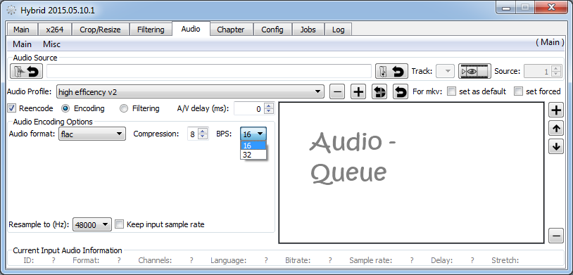

    I have problems with the lack of 24bit option for flac audio compression. I've a lot of HD materials with 24bit audio. There are only two options in Hybrid: 16bit and 32bit
    BYE!

  28. @Trules: if you can upload a sample wit 24bit sampling somewhere and send me a link I can look into it.
    Main problem is, I need to check how to configure the decoders to feed flac properly which is why I need a real 24bit audio sample.

    Hello Selur!
    Simple blu-ray videos, around half of the market were flooded with 24bit so-called DTS audio. Do you have any blu-ray movies at home?
