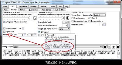

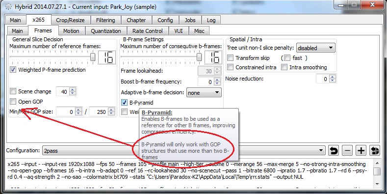

    In the b-pyramid requires the GOP, but in Hybrid I can uncheck to disable and then logic breaks?
  7. GOP = group of pictures
    You disabled "Open GOP" -> x265 then uses 'closed GOP' structures, so there are still GOP structures and if such a GOP contains more then one B-frame, B-pyramid can/will be tested and used if useful.
    -> You really should read up on MPEG compression.
    And before you start fanatically to search for a case where Hybrid doesn't disable b-pyramid when it would make sense I tell you one (which Hybrid knowingly ignores): '--no-open-gop' + '--b-frames 1' + '--keyint 3' would not allow for two b-frames to be inside a gop and in such a case 'b-pyramid' wouldn't be possible and Hybrid ignores this case, since it's simply ridiculous to use such restrictions.

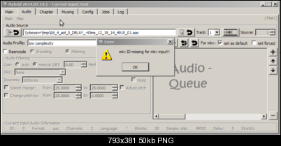

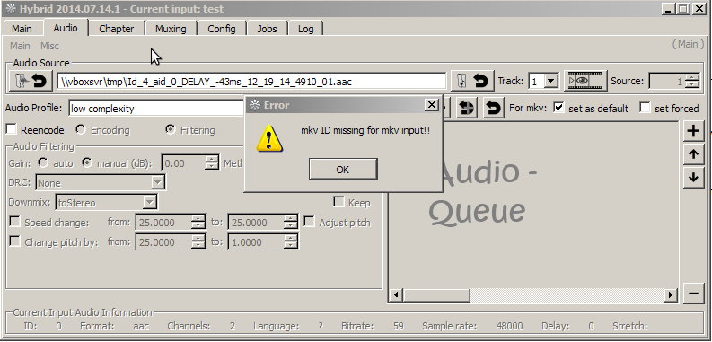

  23. More problems. I have 2 video-files, 'test.mkv' and 'test_sample.mkv', the latter being a 1min sample of the former, as produced by Hybrid. The task, re-encode just the ac3 audio as stereo AAC, the video setting set to 'Ignore'. The problem, when processing 'test.mkv', after successfully encoding the audio, 'Muxing' crashes with the message "crashed:ERROR: \\vboxsvr\temp\test_new.mkv is too small! (byteSize: 0byte)".
    The 1min 'test_sample.mkv' (which exists on the same drive that has multiple gigs of free memory, and uses the same drive for the 'Temp' folder) is processed successfully by Hybrid.
    All of this is with XP. Attached is the Hybrid-debug file. The only odd thing that happens prior to the crash is that the progress-bar stalls at for example 40% then will shoot up to say 80%. But like I said, the aac file that is produced is fine.
    The other 'bug' that I'm sure I mentioned already and am surprised to see still exists has to do with setting an alternate audio source as anything other than an mkv/mp4 file. For instance, if I try using the aac-file produced above as the alternate audio track, on trying to add it to the audio queue, I immediately get a "mkv ID missing from MKV input!!!" error prompt, followed on clicking OK by Hybrid itself crashing! If on the other hand, I select the same aac-file but choose to 'reencode' it, no such error/crash occurs.
    Last edited by omelette; 7th Aug 2014 at 09:03. Reason: Removed HybridDebugOutput.txt...

    No I didn't!!! I have no idea why Hybrid is after appending the 'new' output to an old Hybrid-output file, but that appears to be what has occurred - check the end of the file!!! Another Hybrid bug???

  26. regarding the new: That should happen if the output already exists and 'Generate' is enabled.
    regarding the debug output: the output comes from different versions.
    (Hybrid will always only append to the debug output file, thus if there is already one it will append to it.)
    "mkv ID missing from MKV input" -> I know what happens, a/v source and external audio source get mixed up, thus since the input a/v input is an mkv file Hybrid is looking for an mkv id.
    -> not sure if I come to it today, but it shouldn't be hard to fix
    -> hopefully, fixed it (due to some miracle I got a stable internet connection for a few minutes), send you PM with a link to a test version

  28. 2014.08.07 - 15:14:06_Windows XP-32bit_2014.07.14.1 - level 4: debugging, enabled: false
    -> update to the latest version, which is: 2014.08.06.1 (the version I send you should also already contain a fix for that)
  29. Originally Posted by Selur View Post
    Oops, I thought I had the latest version. Will upgrade!
  30. Upgrade complete! The good news, the "mkv ID missing from MKV input" bug is fixed! Unfortunately, 'muxer' still crashes when processing large videos (>1gig) when it tries wrapping the converted ac3 -> aac-stereo in the mkv container. Like I said, the 1min sample video is re-encoded ok.
    Edit: Ok, I wasn't expecting this - if I re-encode to a mp4 container, no crash! So, something to do with mkv containers methinks!
