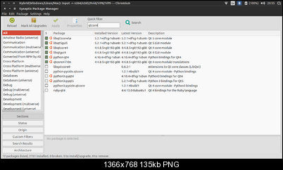

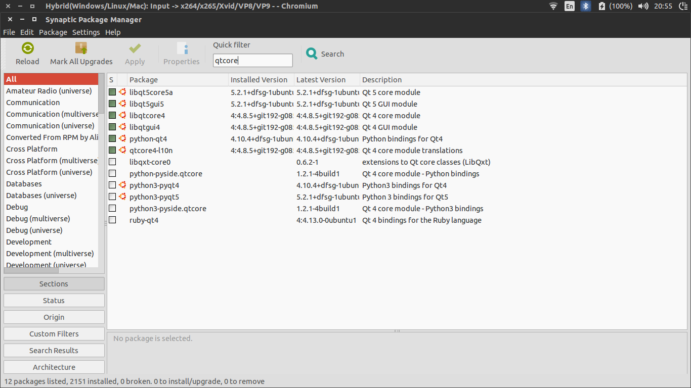

    is this the right one?
Name:	Screenshot from 2014-06-14 20:55:07.png
    i'm using recent one (2014.06.13.1, your website said it) and using 5.2.1 one
  5. really strange, that bug normally shouldn't happen.
    Hmm,.. seeing that both qt 4.8 and 5.2.1 are installed.
    -> is the icon properly placed if you use the qt48 version?
    (not sure how Ubuntu decides which runtime to use)

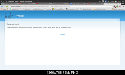

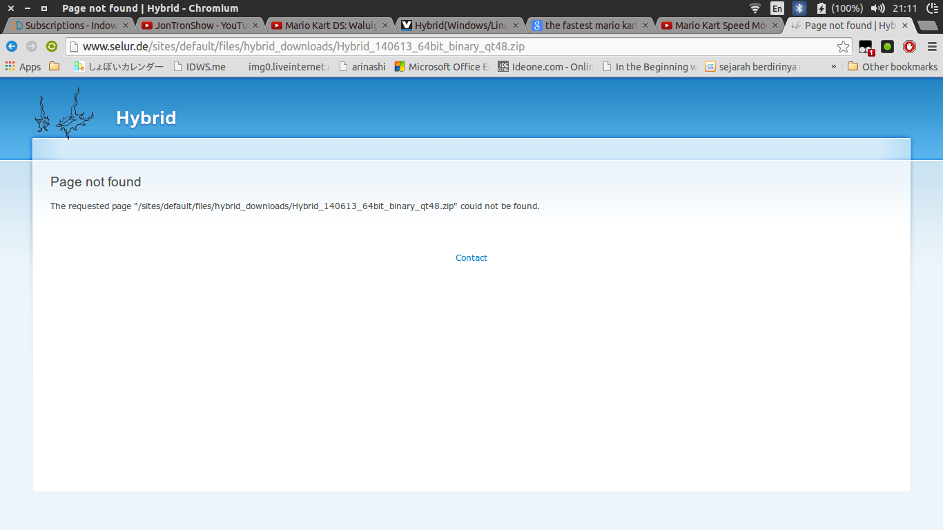

    um...
Name:	Screenshot from 2014-06-14 21:11:53.png
    try 4.6 one instead...
    got weird tray icon and i can't call it back.
  7. fixed the link to the 4.8 version
  8. Originally Posted by Selur View Post
    same weird icon as 4.6 one and i can't click it either.
