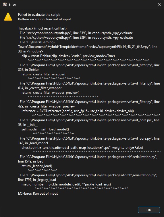

  5. Ok, i did now resize the video with hybrid to 480x270 pixel (and then used that video in a second encode) and it did still crash. I think when you have 10gb VRAM on 1080p is should not run out of vram with a rtx5080 16GB. It ist still the same error:
    2026-03-28 14:48:23.731
    C:\Program Files\Hybrid\64bit\Vapoursynth\Lib\site-packages\torch\functional.py:554: UserWarning: torch.meshgrid: in an upcoming release, it will be required to pass the indexing argument. (Triggered internally at C:\actions-runner\_work\pytorch\pytorch\pytorch\aten\src\ATen\native\TensorShape.cpp:4316.)
    return _VF.meshgrid(tensors, **kwargs) # type: ignore[attr-defined]
    2026-03-28 14:48:23.806
    Failed to evaluate the script:
    Python exception: Ran out of input
    File "src/cython/vapoursynth.pyx", line 3393, in vapoursynth._vpy_evaluate
    File "src/cython/vapoursynth.pyx", line 3394, in vapoursynth._vpy_evaluate
    File "C:\Users\Gaming-Tower\Documents\Hybrid\Tempfolder\tempPreviewVapoursynthFile14_48_21_643.vpy", line 38, in
    clip = vsrvrt.Deblur(clip, device="cuda", preview_mode=True)
    File "C:\Program Files\Hybrid\64bit\Vapoursynth\Lib\site-packages\vsrvrt\rvrt_filter.py", line 857, in Deblur
    return _create_filter_wrapper(
    File "C:\Program Files\Hybrid\64bit\Vapoursynth\Lib\site-packages\vsrvrt\rvrt_filter.py", line 614, in _create_filter_wrapper
    return _create_filter_wrapper_preview(
    File "C:\Program Files\Hybrid\64bit\Vapoursynth\Lib\site-packages\vsrvrt\rvrt_filter.py", line 429, in _create_filter_wrapper_preview
    inference = RVRTInference(config, use_fp16=use_fp16, device=device_obj)
    File "C:\Program Files\Hybrid\64bit\Vapoursynth\Lib\site-packages\vsrvrt\rvrt_core.py", line 53, in __init__
    self.model = self._load_model()
    File "C:\Program Files\Hybrid\64bit\Vapoursynth\Lib\site-packages\vsrvrt\rvrt_core.py", line 143, in _load_model
    checkpoint = torch.load(model_path, map_location="cpu", weights_only=False)
    File "C:\Program Files\Hybrid\64bit\Vapoursynth\Lib\site-packages\torch\serialization.py", line 1549, in load
    return _legacy_load(
    File "C:\Program Files\Hybrid\64bit\Vapoursynth\Lib\site-packages\torch\serialization.py", line 1797, in _legacy_load
    magic_number = pickle_module.load(f, **pickle_load_args)
    EOFError: Ran out of input
    And here is the code:

    And i uploaded also the error-picture. DO you also need a debug ? Hybrid gui says Hybrid 2026.03.27.1 and i did download yesterday the vapoursynth and vsmlrt experimental version from your server and install everything (overwrite-copy).
  6. Can't reproduce, filter is too new to know much about it. Could be something interfering,..
    No clue, maybe the author of the filter has an idea.
