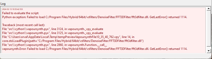

  13. Hi Selur, I downloaded the lastest version of Hybrid today and everything I try to do now seems to make it crash.
    Heres a debug file.
  14. Can't really reproduce the problem here. (debug output didn't help since it ends where you changed the output path; output path determines the debug output location)
    Send you a link to my current dev version (via pm), please share another debug output in case it also crashes with that version.
    Cu Selur

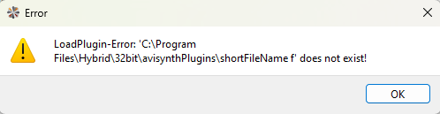

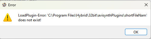

  15. Ok Ive just tried the dev version and the avisynth filters still dont seem to be working. I get two error messages and the the program closes.
    [Attachment 76981 - Click to enlarge]
    [Attachment 76982 - Click to enlarge]
    However those filters did work with vapoursynth selected, although the temporaldegrain2 filter makes it crash.
    Heres a debug output for each of the incidents.
  16. Avisynth.zip ends at outputDir set to(2): C:\Users\orval\Desktop\Sharpen -> no useful data
    TemporalDegrain2 with Vapoursynth, the processing

    seems fine. but Vapoursynth processing fails.

  17. Sorry, only just back with my computer.
    Does the Vapoursynth Preview work?
    It works with TemporalDegrain but when I try to use TemporalDegrain2 it doesnt.
    [Attachment 76993 - Click to enlarge]

  18. Seems like like incompatibility with fft3dfilter.
    Does DeNoise->FFT3DFilter work for you and does it work if you enable 'Neo' in it's settings?
    What CPU are you using? Hybrid uses https://github.com/AmusementClub/VapourSynth-FFT3DFilter which requires AVX2, you can try replacing the fft3dfilter.dll with the one from https://github.com/AmusementClub/VapourSynth-FFT3DFilter/releases/tag/R2.AC3-AVX which also works with CPUs that only support AVX.
  19. FFT3DFilter only works when I select Neo. Without Neo selected, it crashes.
    Its not a good pc so that might be the problem. It has an Intel Pentium Silver N6005. Ill read up and see if I should replace fft3dfilter.dll with the other one that youve linked.
  20. Intel Pentium Silver N6005
    supports: MMX, SSE, SSE2, SSE3, SSSE3, SSE4.1, SSE4.2, SMEP, SMAP, EIST, TM1, TM2, Turbo, SST, AES-NI, RDRAND, RDSEED, SHA
    according to: https://www.notebookcheck.com/Intel-Pentium-Silver-N6005-Prozessor-Benchmarks-und-Spec....514830.0.html
    So no AVX or AVX2. Maybe https://github.com/myrsloik/VapourSynth-FFT3DFilter/releases/tag/R2 works,...
  21. Good call Selur, it worked. Both FFT3DFilter and TemporalDegrain2 are working now. Thanks.

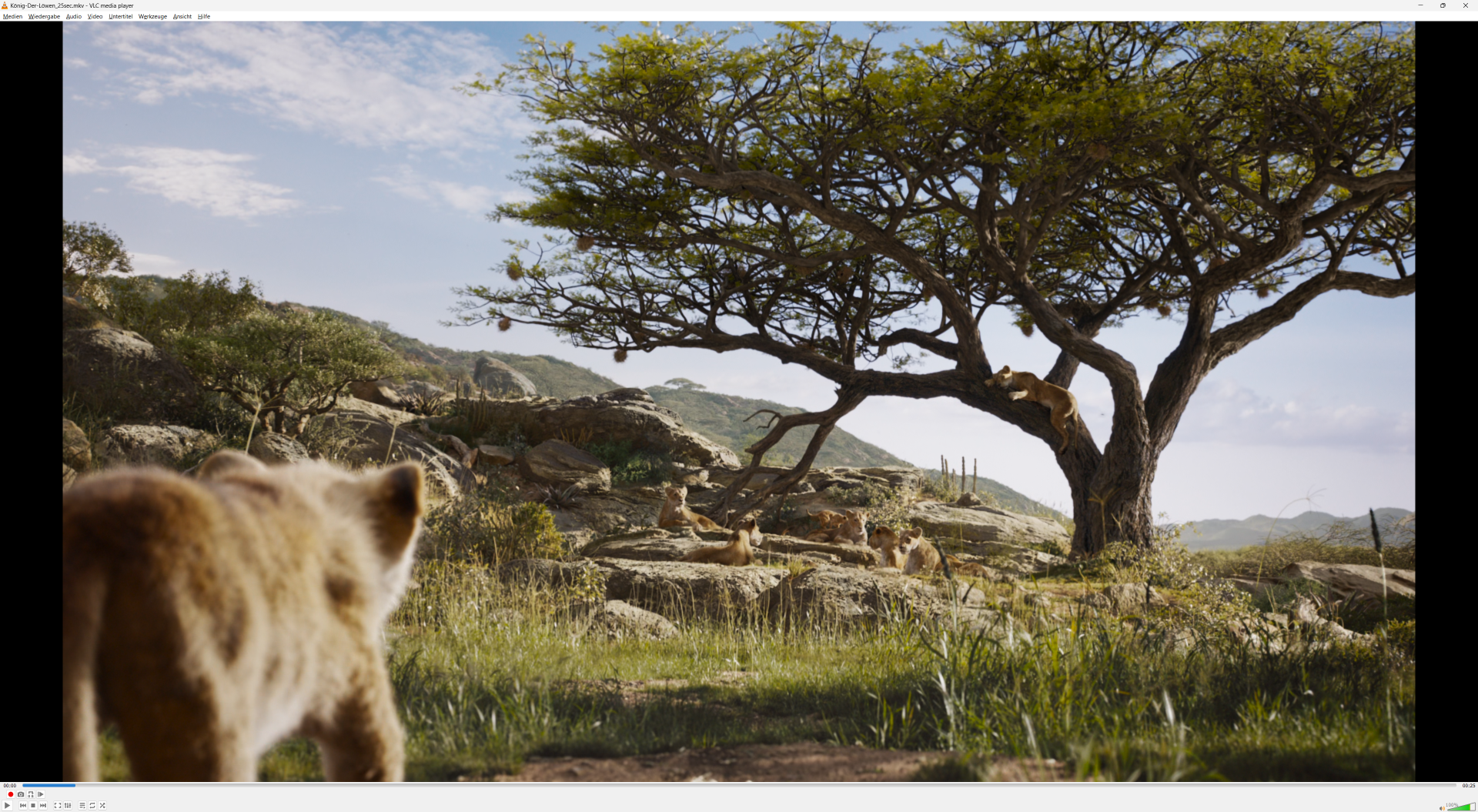

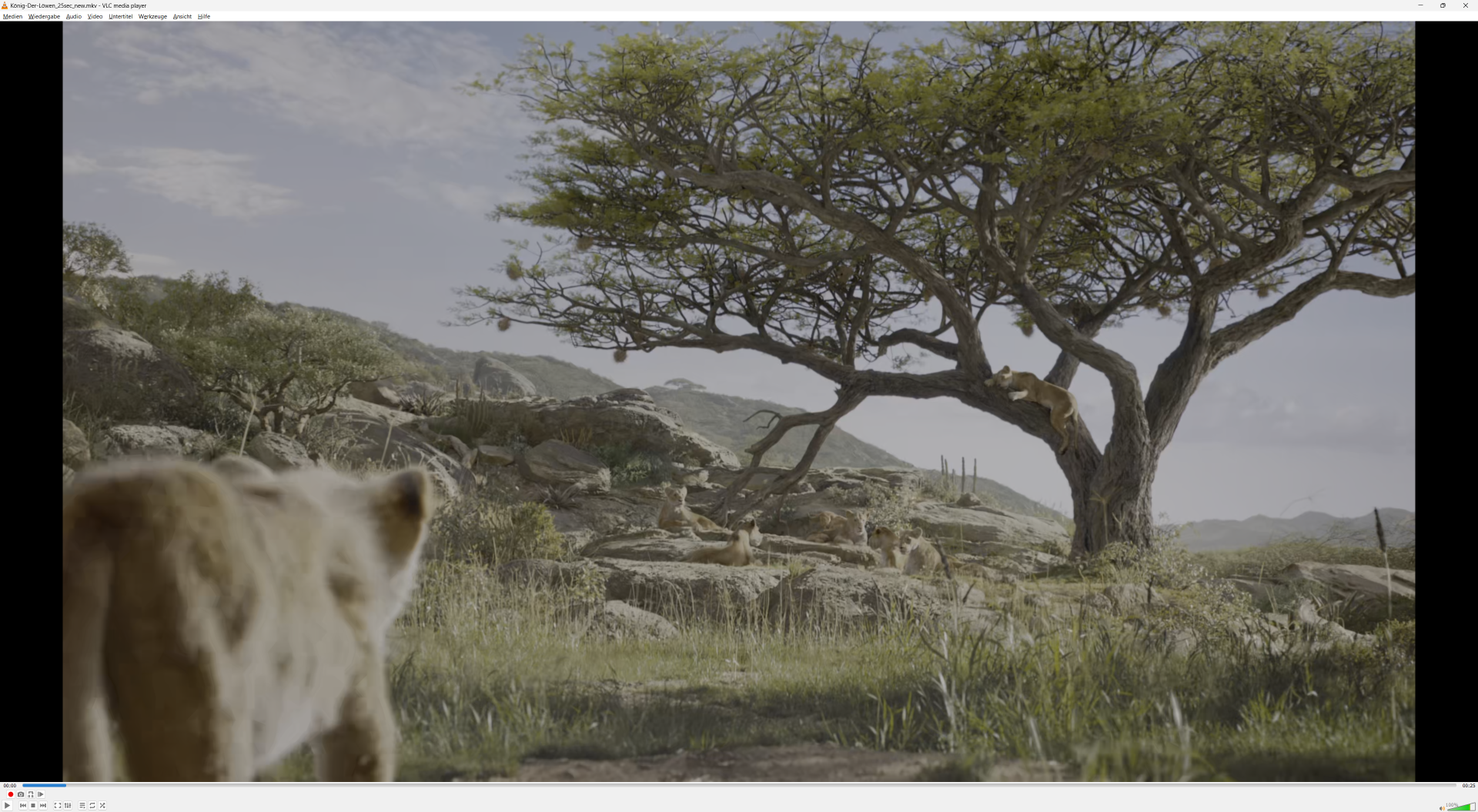

    I have some update information:
    Mediainfo says on the original, that it is HDR10 compatible. I saw now, that mediainfo detects HDR on the reencode, but it is not HDR10 compatible (i uploaded 2 picture for proof).
    So i did not read correctly, sorry. But doesn't change the problem. It looks like hdr is gone away or so. Did upload 2 screenshots to, that you can see. I tested it with VLC, MPC-HC and MPC-BE. Always the same.
    The Screenshots are in 1080p for filesize uploadlimits.

  29. For the input I see:
    Video
    Format                                   : HEVC
    Format/Info                              : High Efficiency Video Coding
    Format profile                           : Main 10@L5.1@High
    HDR format                               : SMPTE ST 2086, HDR10 compatible
    Codec ID                                 : V_MPEGH/ISO/HEVC
    Duration                                 : 20 s 187 ms
    Width                                    : 3 840 pixels
    Height                                   : 2 160 pixels
    Frame rate mode                          : Constant
    Frame rate                               : 23.976 (24000/1001) FPS
    Chroma subsampling                       : 4:2:0 (Type 2)
    Bit depth                                : 10 bits
    Writing library                          : ATEME Titan File 3.9.0 (4.9.0.0)
    Default                                  : No
    Forced                                   : No
    Color range                              : Limited
    Color primaries                          : BT.2020
    Transfer characteristics                 : PQ
    Matrix coefficients                      : BT.2020 non-constant
    Mastering display color primaries        : Display P3
    Mastering display luminance              : min: 0.0001 cd/m2, max: 1000 cd
    Using:
    ffmpeg -y -loglevel fatal -noautorotate -nostdin -threads 8 -i "C:\Users\Selur\Desktop\Konig-Der-Lowen_10sec_edit.mkv" -map 0:0 -an -sn -color_primaries bt2020 -color_trc smpte2084 -colorspace bt2020c -color_range tv  -pix_fmt yuv420p10le -strict -1 -vsync 0 -f yuv4mpegpipe - | NVEnc --y4m -i - --fps 23.976 --codec h265 --profile main --level auto --tier high --sar 1:1 --lookahead 16 --output-depth 10 --vbr 0 --vbr-quality 23.00 --aq --aq-strength 5 --aq-temporal --gop-len 0 --ref 7 --multiref-l0 3 --multiref-l1 3 --bframes 3 --bref-mode auto --mv-precision Q-pel --preset quality --colorrange limited --colorprim bt2020 --transfer smpte2084 --colormatrix bt2020nc --max-cll ,1000 --master-display G(13250,34500)B(7500,3000)R(34000,16000)WP(15635,16450)L(10000000,1) --cuda-schedule sync --output "J:\tmp\Konig-Der-Lowen_10sec_edit_new_1_2024-02-29@15_54_39_0210_01.265"
    I get:
    Video
    Format                                   : HEVC
    Format profile                           : Main 10@L6@High
    Codec ID                                 : hvc1
    Codec ID/Info                            : High Efficiency Video Coding
    Bit rate                                 : 14.3 Mb/s
    Maximum bit rate                         : 22.3 Mb/s
    Bit depth                                : 10 bits
    Bits/(Pixel*Frame)                       : 0.072
    Stream size                              : 34.4 MiB (100%)
    Encoded date                             : 2024-02-29 14:50:22 UTC
    Tagged date                              : 2024-02-29 14:50:23 UTC
    Mastering display luminance              : min: 0.0001 cd/m2, max: 1000 cd/m2
    mdhd_Duration                            : 20270
    Codec configuration box                  : hvcC
    Strange thing is the 'Transfer characteristics' is missing!
    Hybrid does tell NVEncC to set it using:
    Okay, according to https://github.com/rigaya/NVEnc/blob/master/NVEncC_Options.en.md#--transfer-string
    this should work.
    => I filed an issue entry with the NVEncC developer. Doesn't look like a bug in Hybrid to me.
    Cu Selur
