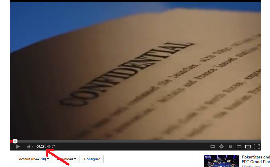

    Video time prompt
Name:	video time prompt.png

  24. Ah, okay. (would have called that the time/position indicators )

    Budapest
