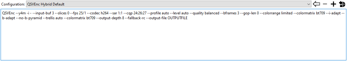

    I also have a question about something I just noticed:
    As you can see in the screenshot below, "--colormatrix" is added twice, is this intentional?
  24. Don't see a screenshot,.. but I checked the code an in QSVEnc VUI setting are set twice, which shouldn't break anything, but I'll fix it.
    Cu Selur
  25. Strange... to me it appears. But you found the right thing anyway.
