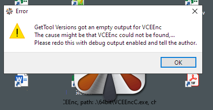

    installed Hybrid (2021.7.18.0) on Win 10 (21H1, 19043.1288) for the first time.
    When starting Hybrid an error message pops up:
    [Attachment 61506 - Click to enlarge]
    Klicking OK lets the software disappear, no Hybrid comes up and no debug output possible.
    The latest thread about VCEEnc in your forum seems not to match my problem.

  26. Hybrid calls VCEncC with:
    VCEncC.exe --check-version
    unless that call works on your system VCEncC will not work.
    On my systems, calling the above at least gives:
    VCEEncC.exe --check-features
    Failed to load amfrt64.dll.
    VCE not available.
    VCE not available.
    On your system the call does not seem to work at all and simply crash.
    This usually happens if there's a problem with the VCEncC version (https://github.com/rigaya/VCEEnc/releases) and the drivers you use or some anti-virus tool is interferring.
    -> If you want to know hat happens, test what your system does when calling the above call inside your Hybrid/64bit folder.
    You could also tell Hybrid to not ignore VCEncC, by creating a misc.ini with:
    [General]
    ignoreTools=VCEEnc
    Cu Selur

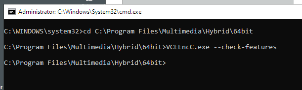

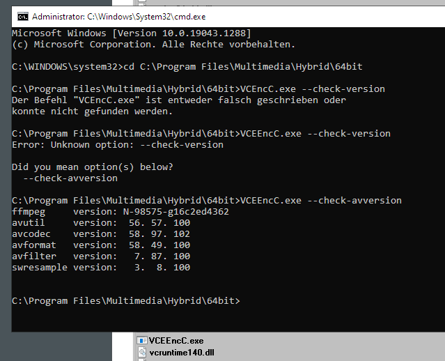

    Calling "VCEEncC.exe --check-version" gives me an error.
    [Attachment 61507 - Click to enlarge]
    Calling "VCEEncC.exe --check-features" gives no output.
    [Attachment 61509 - Click to enlarge]

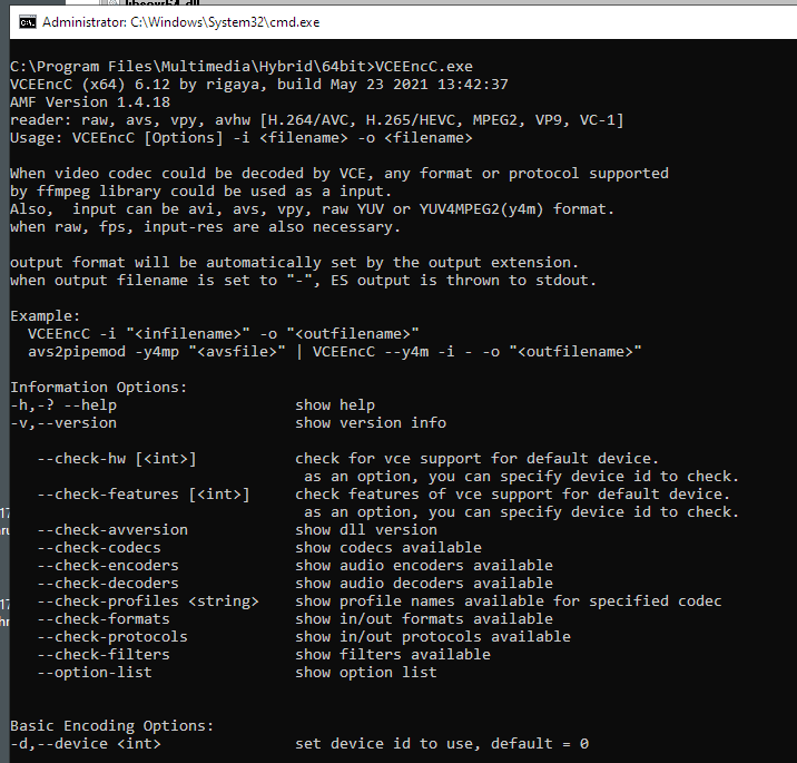

    Just calling "VCEEncC.exe" shows the following.
    [Attachment 61508 - Click to enlarge]
    I'll have a look at github.

  28. Sorry, I meant
    before not version
    And that is something Hybrid does not expect.
    I keep my fingers crossed.
    Cu Selur
