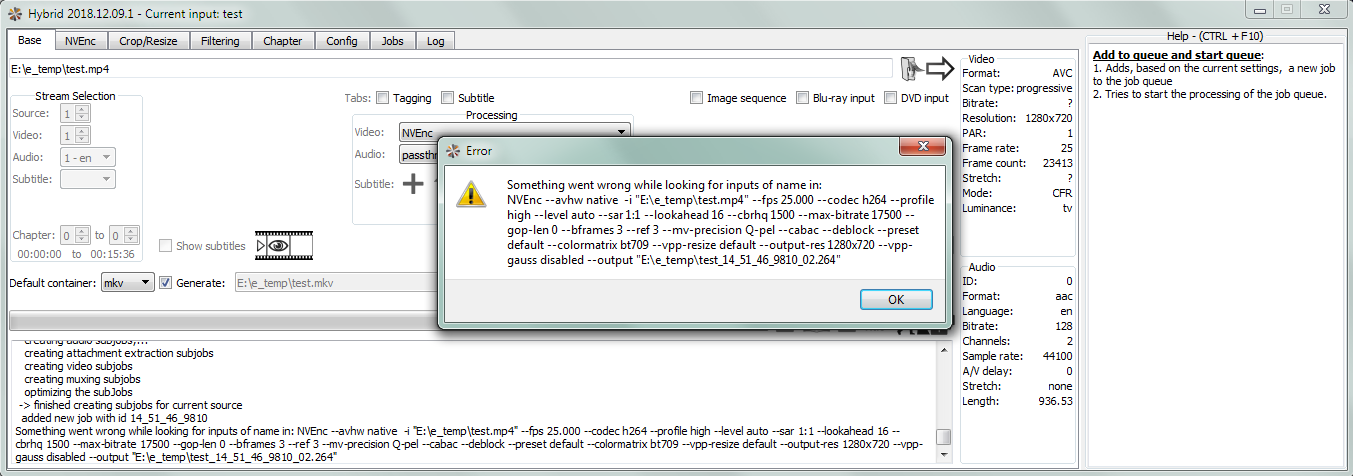

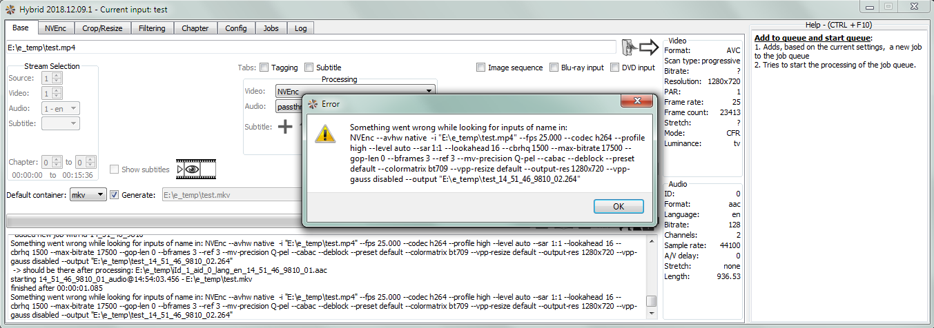

  5. I have small issue with latest version of Hybrid.
    Encoding with NVEnc working ok, BUT if i change one option (NVEnc -> Filtering -> Only use encoder) i see this window two times.
    [Attachment 47435 - Click to enlarge]
    [Attachment 47436 - Click to enlarge]
    I press OK and encoding process going on. Output file is ok.
    This was not happened in v2018-11.
  6. Yeah, thats an unwanted side effect of the me rewriting the job processing.
    Must have overlooked that. Will fix.
    -> send you a PM with a link to a version which should fix the problem

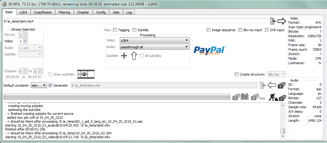

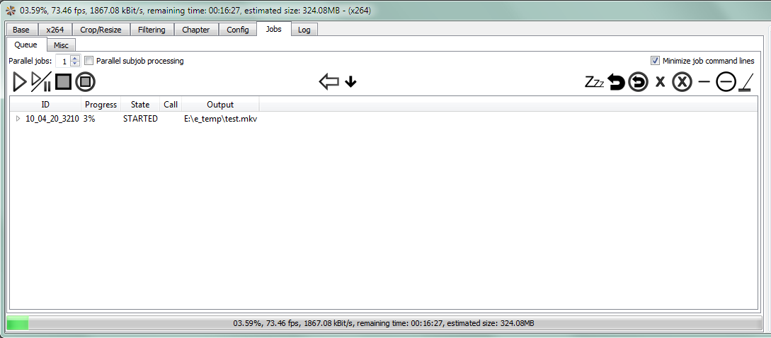

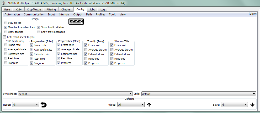

  27. I have strange issue, since few updates progress bar in main window is empty during encoding. In Jobs window working OK.
    [Attachment 49568 - Click to enlarge]
    [Attachment 49569 - Click to enlarge]
    [Attachment 49570 - Click to enlarge]
  28. yeah, stumbled over that last week, will be fixed in next release.
