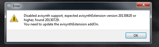

  20. My mistake.
    I'm using 2013.08.30.1 Sorry
    I saw you mentioning 08.20 and I guess I typo'd
    It doesn't work.

  21. -> You used an old link to the dev version, but you don't have the link to the dev avisynthExtension.
  22. Nah I'm using the new version and I'm getting the error.
  23. You are using the development build of Hybrid, but you are not using the development version of the Avisynth extension,...
    btw. I just released version 20130901
  24. Originally Posted by Selur View Post
    I see. Hehe sweet. I'll get the new version then
