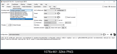

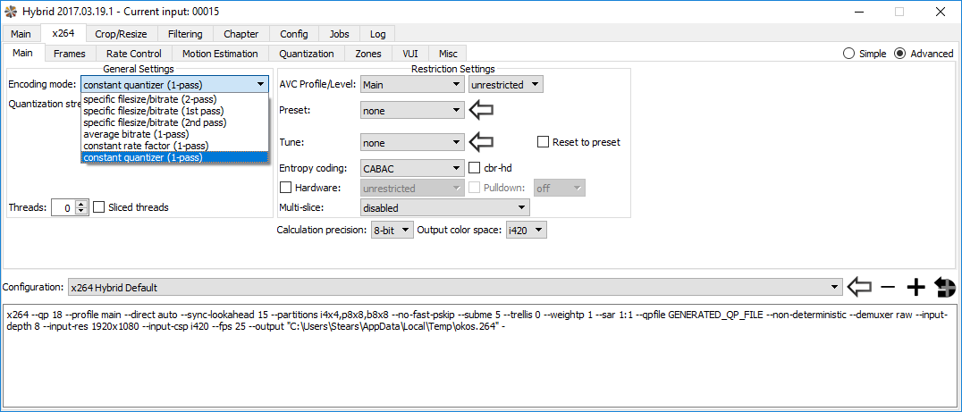

  11. Lossless encoding through x264 has been supported for years,..
    Set 'x264->Main->General Settings->Encoding mode' to 'constant quantizer (1-pass)' and make sure you select an AVC profile (x264->Main->Restriction Settings->AVC profile) which supports lossless encoding (see tool top of 'Lossless') and Hybrid allows you to enable lossless encoding (by enabling 'x264->Main->General Settings->Lossless').
  12. Click image for larger version
    [Attachment 41036 - Click to enlarge]

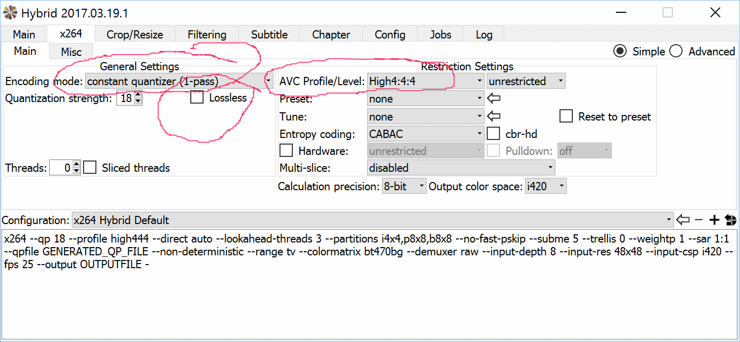

    I tried to do it, but the lossless mode didn't appear.
    [Attachment 41037 - Click to enlarge]
  13. made a picture for you
    [Attachment 41039 - Click to enlarge]
  14. Originally Posted by Selur View Post
    Hi!
    Thank you!
    The lossless mode works.
    But wouldn't it be more easy to create a "lossless" option directly in the "encoding menü" of the X264 options ? And it works only in high 4:4:4 colorspace. Yes I know that there is an option to revert back the colorspace to 8bit 4:2:0 (i420), but wouldn't it cause unnecessary colorspace conversions which can reduce the quality?
    In the VFW version of x264, I can choose varios options about the compression ratio of the lossless x264 version of h264, (the preset option) , but I can't use the preset options in the lossless x264 mode of Hybrid. The preset option can change the size of the lossless video.
  15. Despite its name the "High 4:4:4 Predictive" profile supports 4:2:0 encoding. There is no colorspace conversion.
    See table:
    https://en.wikipedia.org/wiki/H.264/MPEG-4_AVC#Profiles

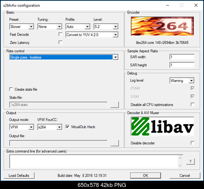

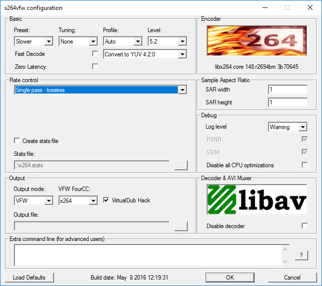

  19. Originally Posted by Selur View Post
    Preset choice isn't restricted by enabling lossless at all, so one selects and applies a preset.
    Also since the x264 vfw interface was dropped over 10 years ago (at the end of October of 2006 iirc) and all later vfw versions are non-official, I wouldn't recommend to use that interface as comparison basis.
    re
    As you can see on the picture
    It is the 1y old (maybe unofficial release) of x264 VFW encoder. As you can see the presets are optionalble in the lossless mode. It's key importance that it can reduce the lossless filesize with 20% in a comparison with Hybrid's x264 lossless mode.
    How is it posible?
  20. As you can see the presets are optionalble in the lossless mode.
    As they are in Hybrid.
    It's key importance that it can reduce the lossless filesize with 20% in a comparison with Hybrid's x264 lossless x264 mode.
    It's not Hybrids fault that you didn't tell it to apply a preset,..
    How is it posible?
    How should anyone know why you didn't choose to not select and apply a specific preset in Hybrid?
    -> not sure what your problem is,..

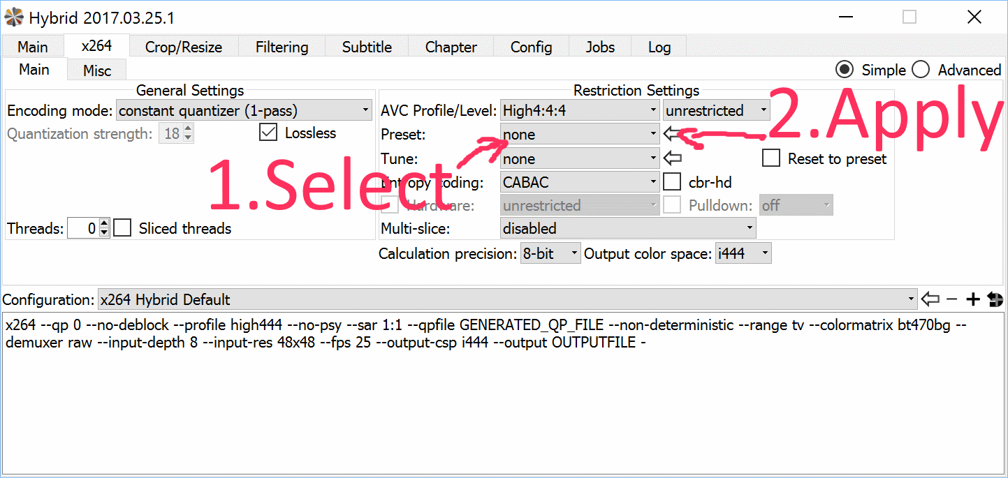

  22. If your problem is the compression ration with a fast preset, then why not select and apply another preset?
    Since I sill don't understand the problem, I attached an image on where to select and apply a preset,...
    [Attachment 41046 - Click to enlarge]
    Cu Selur
