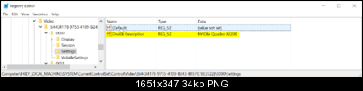

    Hi Selur
    I have exported the mentioned key from my registry and uploaded here. Can you take time and have look?
    JH
  3. Card is reported as 'NVIDIA Quadro K2200', will add it to the list of compatible cards and send you a link to a test build once I'm finished with the building.
    Cu Selur
