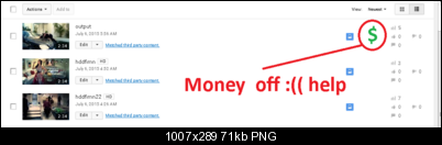

    @Selur
    Hi,
    I'm doing a video installation, Video Coming license.
    Video installation by someone else; Copyright passed
    Video help pass obstacles
    https://www.youtube.com/watch?v=O_S7B86XrI8
    Paid, make free video rendering programs.
    please help
  5. Linked video looks like there was a problem with the color space alignment.
    If this was created with Hybrid I would need a debug output (+may be a small source sample) to see the source of the problem.
    see: http://www.selur.de/support
    If the file send to youtube wasn't send created with Hybrid, the problem seems to be a color space a alignment issue, which normally happens if a decoder and encoder (or filter) combination assume different input and output color samplings.
    -> atm. not enough information to help
    Cu Selur

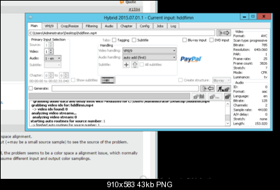

    Jul 2015
    Fransa
    skype adress fullcom.org add
    youtube copyright: to pass
    make video rendering
  7. skype adress fullcom.org add
    skype: rarely use it and only for family calls (and when calling a few friends in china)
    Doesn't YouTube reencode everything no matter what nowadays?
    Last time I checked converting avc to vp9 didn't really make sense for youtube uploaders since youtube would still reencode another time.
    you didn't read the infos that would be needed for me to reproduce a problem, did you?
    (tried with different samples and got no problems converting AVC content to vp9 here)

  9. Sorry, but it seems like some of the meanings you wanted to translate got lost during translation.
    Cu Selur

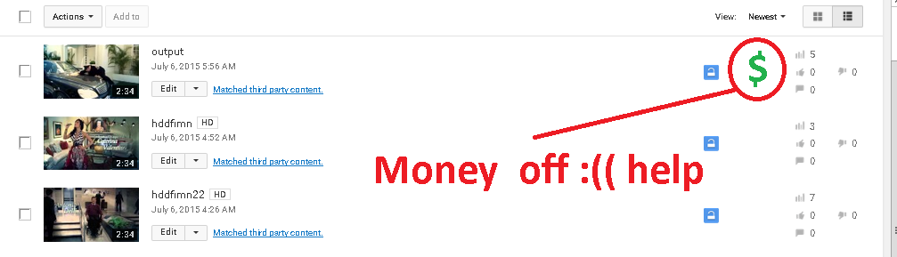

    Jul 2015
    Fransa
    Matched third party content
    blocked in some of the world
    youtube videos to pass the obstacles on.
    to actively make money
    video rendering programs to teach
  11. @all: can someone make heads or tails out of what MS-HD is writing? it look more and more to spam to me.
    @MS-HD: if you need Hybrid related help please read the support page and try to better describe your problem.
    If you need help with something not related to Hybrid, best create a separate thread.
