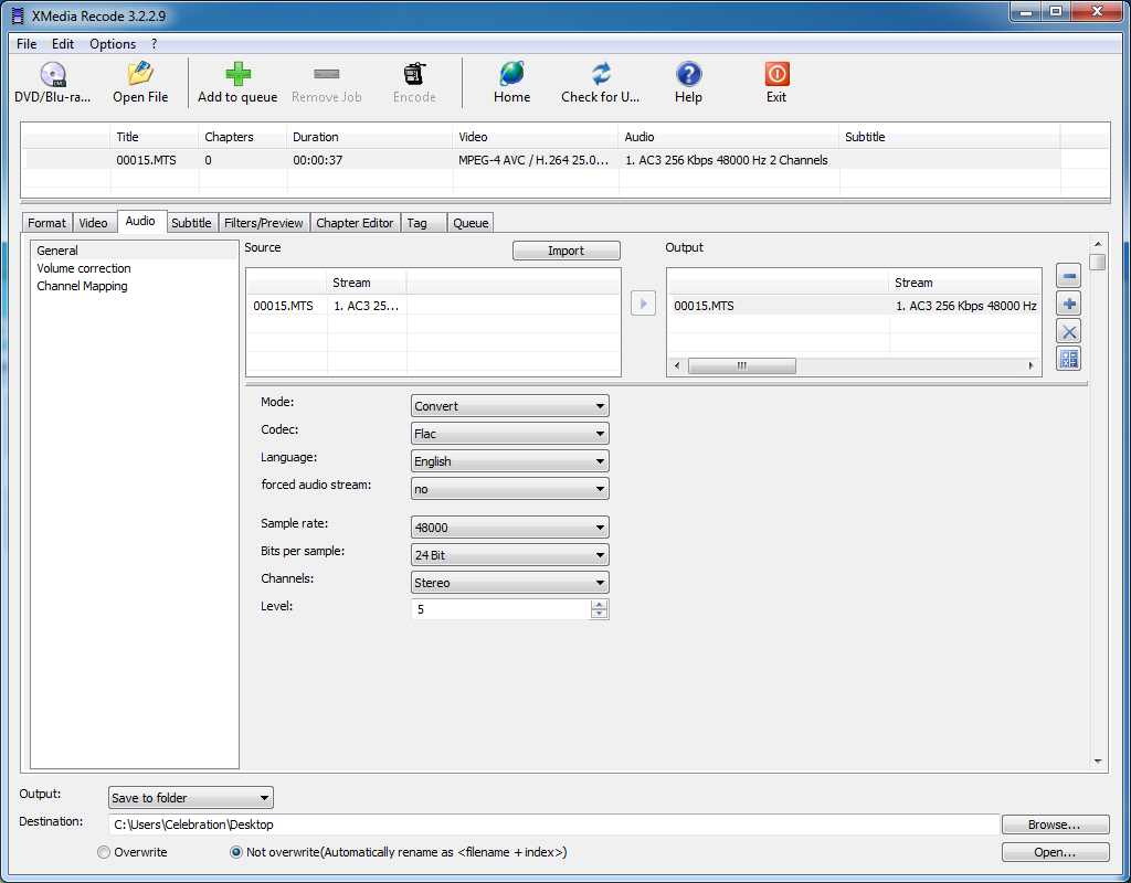

    HI!
    Can the Hybrid handle the video as a separate video and audio stream during the transformation process, and put them together at the end? For example: an ffmpeg-based video compression and separate flac plugin for audio compresion. Fortunatelly the flac is 100% free. Interestingly, ffmpeg can play the audio files with 24bit audio without problems, despite the fact it can not encode them. It is a very very important task, because the blu-ray disc is a main video format like the DVD disc.
    For example: the XMedia Recode software has only 16bit and 24bit options for FLAC audio.
    Which encoder is used by the xmedia?
  4. Can the Hybrid handle the video as a separate video and audio stream during the transformation process, and put them together at the end?
    Yes
    No, clue probably the standard stand alone encoder or the standard lib.

    Do you think that a similar (xmedia like solution) audio codec lib can solve the 24bit flac problems in Hybrid?
  6. Nope, but Hybrid already comes with the normal flac binary (mainly as a fallback)
    -> main thing to do for me is doing some testing
