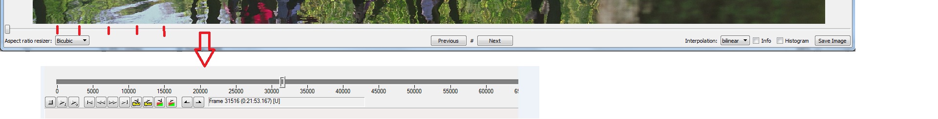

    All done. Do check mark to display the time scale (the scroll bar) for easy navigation of the preview?
  10. Sorry, the meaning of that sentence got lost during translation. No clue.

    Kazakhstan
    Transition in ss:mm:hh To quickly find a particular scene.

  12. won't come any time soon, since mplayer as backend isn't relyable enough,... you could turn on the OSD display by pressing 'O'

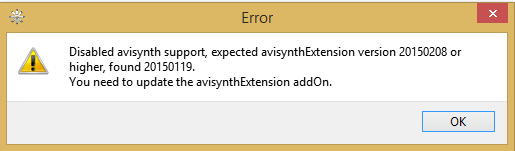

    I downloaded the new hybrid version but when I run it I face this error:
    why is this happen ?
    I download the avisynth 2.5.8 and install it but nothing change !!!
    so what should I do ?
    tnx in advance

    Hi litoo!
    Avisynth Extension > http://www.selur.de/downloads (by replacing files and folders).
  17. Originally Posted by Gravitator View Post
    Hi litoo!
    tnx for help!
    but when I replaced that files and folders I face a new error:
    so what now ?
    why this avisynth error happen in new version ?
  18. Originally Posted by litoo View Post
    Hi litoo!
    tnx for help!
    so what now ?
    Delete avsViewer and avsInfo from main Hybrid folder (not dynamic folder)

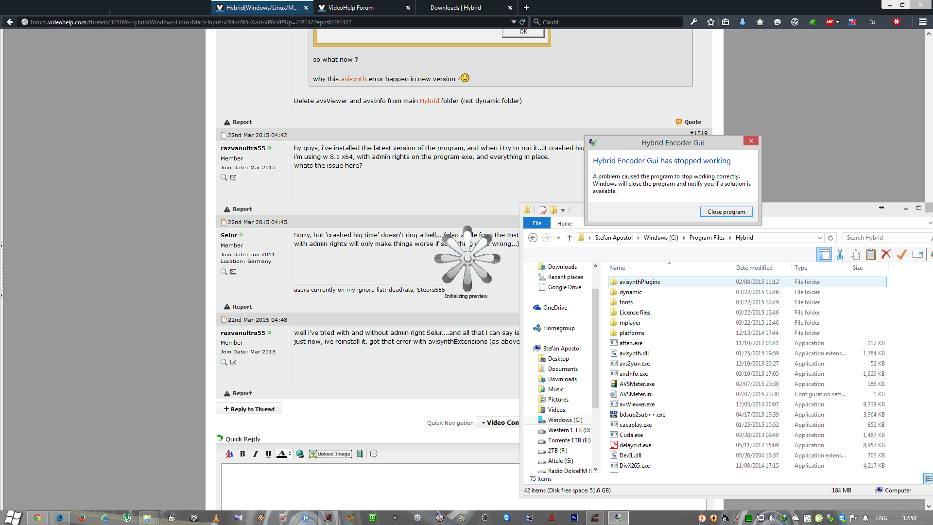

  19. hy guys, i've installed the latest version of the program, and when i try to run it...it crashed big time.
    i'm using w 8.1 x64, with admin rights on the program exe, and everything in place.
    whats the issue here?
  20. Sorry, but 'crashed big time' doesn't ring a bell,.. (also aside from the Installation, Hybrid does not require admin rights and running it with admin rights will only make things worse if something goes wrong,..)
  21. well i've tried with and without admin right Selur....and all that i can say is that it does not run...
    just now, ive reinstall it, got that error with avisynthExtensions (as above), and after that crash...
  22. Click image for larger version
    as you can see, everything is in place into program folder...and still crashes...i don't know why.
  23. Reinstalled = deinstalled old Hybrid, then installed new Hybrid?
    Try:
    1. deinstalling Hybrid, make sure Hybrid folder is deleted
    2. downloading Hybrid from http://www.selur.de/downloads
    3. reinstalling Hybrid
    Cu Selur
  24. i've just did that, my friend, everything was deleted before reinstalling your latest version, from your site, twice may i say.
  25. Strange thing, is I did the same thing and here I get no problem. Really strange,..
    You can also try if it helps to remove all settings&co during deinstallation.
  26. yap, i know....and its enoying... i really don't know what to do.
