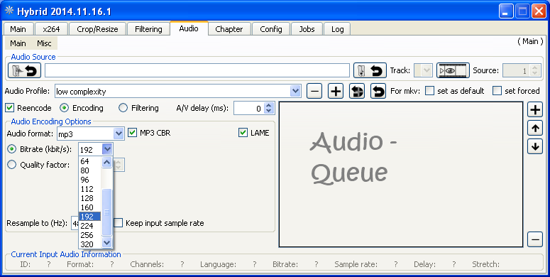

    I just tried the Hybrid_2014.8.14.1 to test AVI container, but I get an error report.
    The Log says: "muxing crashed:One or multiple files were not created properly!"
    Job converting AVI: x264 (No change)| Audio mux from source WAV Reencode to MP3 48.0 KHz - 160 kbps CBR Lame
    I got a warning like the Log above, but the result is still obtained finishing AVI. Then when I see in %TEMP% folder, the two mix streams: audio (MP3) and video (less extension) are still there.. so weird!
    Convert to MP4 do the same job, there is working good without any problem, also same good for Reencode to AAC (Qaac).
    So, I think it seems problem to MP3..?
    Leo99

    Oops.. there is still problem in the Hybrid 2014.11.16.1
    On tab Audio: Selecting options in the box of Bitrate is "Error"!
    Leo99
  10. too few details to reproduce,...
    Aug 2008
    at 3rd region
    So funny, how can you make a debug report, while for the bitrate alone cannot be set at all..!
    The Bitrate box only contains numbers 1 - 9..?? Supposedly numbers: 96 128 160 192 224 256 etc...
    Leo99

    Aug 2008
    at 3rd region
    @gonca: What might I use XP causes the display look so different? I don't know...
    @Selur: Nope.. it has nothing to do with fhgaacenc and VBR mode, I think. Or caused of XP that I using..?
    Here's the Audio encode to AAC MP3 AC3 OGG, please see this screenshot: http://files.videohelp.com/u/158959/Audio_encode.jpg

  17. I installed the latest version (2014.11.16.1) in a Windows XP virtual machine and couldn't reproduce the problem.
    Here the bitrate selection ComboBox is as it should.

    Selur, I've downloaded again + reinstalled to the all, but the result is still the same.
    Then, test converting AVI includes debugging enabled, as follows:
    1. The ComboBox still problems, it listed numbers of 1-9.
      The #1 there are four: 1=112, 1=128, 1=160, 1=192 kbps (I know to the the right box Audio Queue)
    2. I got a report: "muxing crashed:One or multiple files were not created properly!"
    3. When finished, in the %TEMP% folder has 2 files: (but I still got the finishing AVI completely)
      - air on g string_21_07_35_5110_03.264
      - iId_48_aid_0_21_07_35_5110_01.mp3
    4. Attached 2 files of the debug report and log.txt
      - http://files.videohelp.com/u/158959/HybridDebugOutput.txt
      - http://files.videohelp.com/u/158959/Log.txt
    Thank you for listening to...
    Leo99
  19. Is your Windows XP up-to-date? Still can't reproduce the ComboBox issue you have. (And I now tried 1 VM, 1 Laptop with Windows XP and asked three other users which all confirmed that they do not have any problem with the visualization.)

    Selur, now it returns back to normal. Just simple, I do Reset All to Defaults (Removed my previous settings) - ComboBox is solved!
    But there is still problems in AVI, but I still got a complete finishing AVI (despite having 2 files in %TEMP% folder.. bugs?). This for AVI only, other containers are good without bugs.
    Also, after Reset all, in the Audio tab on Reencode > if I select AAC followed Qaac checklist box > the ComboBox of bitrate is "blank" > if unchecked will "repopulate" > There are no problems to the 3 others such as Nero AAC, FHG and FAAC.
    Thanks for listening to.
    Leo99
