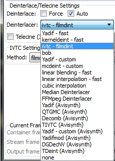

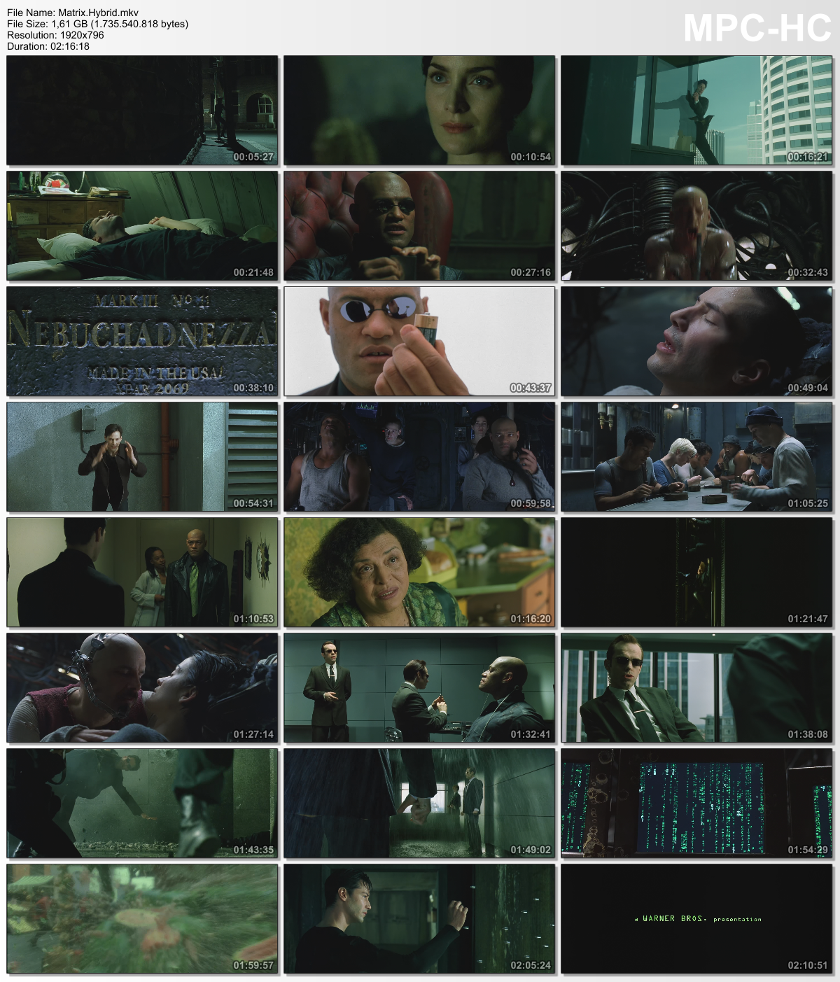

    DVD mod
    Name:  DVD mod -deinterlace.jpg
    Simple mod
    Name:  general mod -deinterlace.jpg
    Noticed limiting the choice of methods deinterlacing for DVD mod.
  20. Read the tool-tip of "Config->Internals->Avisynth->Avisynth for DVD input"
