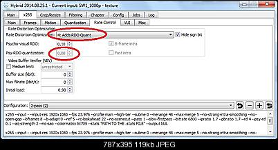

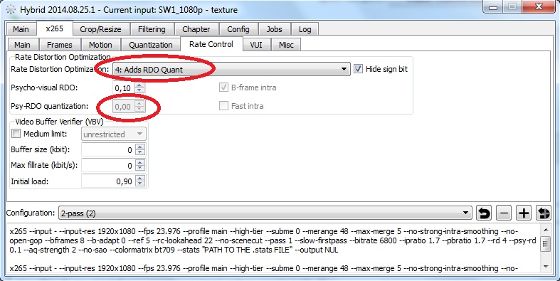

    Not active mode settings Psy-RDO quantClick image for larger version

  29. @Graviator: will fix, it's an index error (it's enabled for 5+ instead of 4+ )
