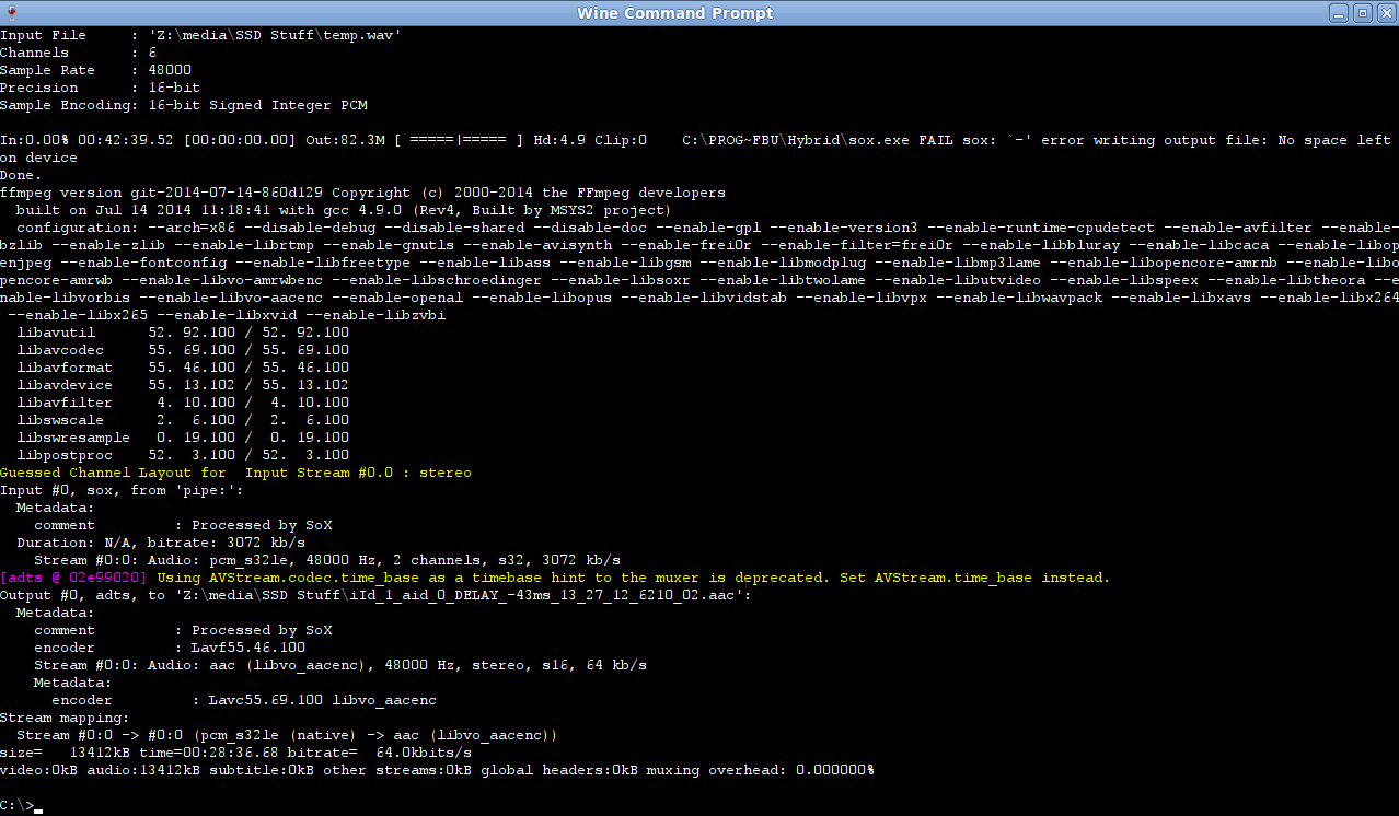

  3. Running the first one from the Linux terminal (preceded by 'wine' - I couldn't get the M$ terminal to run) showed why it was crashing - I was running out of disk-space! How about a check-for-sufficient-space-for-cache? Makes sense to me anyway! So, the 'crashing' bit has been solved.
    So after freeing up disk-space, I've also being trying various combinations and have had a few 'realisations'. First, to reproduce this problem, all it is necessary to do is to try down-mixing the audio, the 'video-handling' being set to 'ignore'. In other words, it has nothing to do with the recombining-audio bug (that you've fixed) that I started out with.
    Most importantly, this sox caching 'hanging' problem doesn't occur with either Hybrid 2014.4.2.1 or 2014.4.4.1, the only other 2 Hybrid binaries that I have. This only happens with Hybrid 2014.07.10.1. I also forgot that I could install this current version on Wine emulating System 7, which I have now done. Sure enough, x264 and sox are detected - so no need for the XP fixed binary that you PM'ed me. But, the bug also persists when installed under Wine emulating System 7. I have also tried this under 3 different versions of Wine - 1.6.2, 1.7.16 and 1.7.20 - with the same results with each of them.
    So it certainly seems (to me) that Hybrid is the culprit. The fact that it gets so close to finishing the caching (99.79% for example) every time suggests to me a variable-type problem - could it be a integer/double issue, or along those lines? The fact that the problem doesn't exist on older Hybrid's seems fairly conclusive.

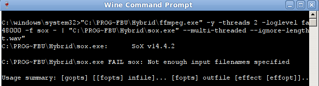

    Does calling:
    "C:\PROG~FBU\Hybrid\ffmpeg.exe" -y -threads 2 -loglevel fatal -i "Z:\media\SSD_~JS5\iId_1_aid_0_DELAY_-43ms_13_27_12_6210_01.ac3" -ac 6 -ar 48000 -f sox - | "C:\PROG~FBU\Hybrid\sox.exe" --multi-threaded --ignore-length --temp "Z:\media\SSD Stuff" --buffer 524288 -S -t sox - -b 16 -t sox - remix -m 1v0.3694,3v0.2612,5v0.3694 2v0.3694,3v0.2612,6v0.3694 norm | "C:\PROG~FBU\Hybrid\ffmpeg.exe" -y   -threads 2 -f sox -i - -c:a libvo_aacenc -b:a 64k -ac 2 -ar 48000 "Z:\media\SSD Stuff\iId_1_aid_0_DELAY_-43ms_13_27_12_6210_02.aac"
    inside a terminal work for you?
    Cu Selur
    Ps.: @all: does anyone else have this problem on his/here Windows XP system?

    Does it work if you first call:
    "C:\PROG~FBU\Hybrid\ffmpeg.exe" -y -threads 2 -loglevel fatal -i "Z:\media\SSD_~JS5\iId_1_aid_0_DELAY_-43ms_13_27_12_6210_01.ac3" -ac 6 -ar 48000 -f wav "Z:\media\SSD Stuff\temp.wav"
    (this should create a wav file "Z:\media\SSD Stuff\temp.wav")
    and then
    "C:\PROG~FBU\Hybrid\sox.exe" --multi-threaded --ignore-length --temp "Z:\media\SSD Stuff" --buffer 524288 -S "Z:\media\SSD Stuff\temp.wav" -b 16 -t sox - remix -m 1v0.3694,3v0.2612,5v0.3694 2v0.3694,3v0.2612,6v0.3694 norm | "C:\PROG~FBU\Hybrid\ffmpeg.exe" -y   -threads 2 -f sox -i - -c:a libvo_aacenc -b:a 64k -ac 2 -ar 48000 "Z:\media\SSD Stuff\iId_1_aid_0_DELAY_-43ms_13_27_12_6210_02.aac"
    (this should feed the wav to sox and then reencode the sox output with ffmpeg)
    Both seem to run fine. The second one does issue a "sox.exe WARN formats: sox can't encode to 16-bit." but seems to complete normally (see pic).
    addition:
    You can also try if it works if you use a shorter file, may be the problem is not the piping in general but may be size available for those pipes is limited.
    Cu Selur
    Using a 1min sample created by Hybrid from the 'text.mkv' I've been using, the same thing happens, except instead of sox managing to cache to 99.xx% completion, it now varies between 65.xx% -> 91.xx% This is using the dev-release of 'hybrid.exe' that you PM'ed me, overwriting the Hybrid 2014.07.14.1 executable. I only have 4 of these 5.1-audio videos to hand, each about 50min duration, but they all produce the same result.

    Running that line from the command-line produces an error. Please note that Wine's CLI emulation is really bad - word-wrap doesn't work properly, so although you can't see it in the below pic, the complete line you supply above is being supplied for execution.
    Cu Selur[/QUOTE]
  24. you probably have to use:
    wine "C:\PROG~FBU\Hybrid\ffmpeg.exe" -y -threads 2 -loglevel fatal -i "Z:\media\SSD_~JS5\iId_1_aid_0_DELAY_-43ms_13_27_12_6210_01.ac3" -ac 6 -ar 48000 -f sox - | wine "C:\PROG~FBU\Hybrid\sox.exe" --multi-threaded --ignore-length --temp "Z:\media\SSD Stuff" --buffer 524288 -S -t wav "Z:\media\SSD_~JS5\soxOutput.wav"

  27. Originally Posted by Selur View Post
    No, I get the same error;
    C:\PROG~FBU\Hybrid\sox.exe FAIL sox: Not enough input filenames specified

    Yep, that works fine.
