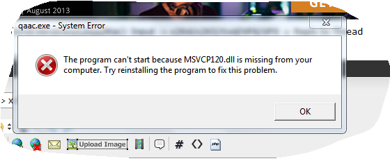

this new version gives 2 error messages that prevent it from launching most of the time, one about qaac and one about msvcp120.dll missing and something about an empty output for qaac and the one time it did launch i noticed that you didn't include the divx encoder, it's not included in the install directory. -
@deadrats:
it should be in the dynamicX folder.i noticed that you didn't include the divx encoder, it's not included in the install directory.
What does the message of the msvcp120.dll error say exactly?this new version gives 2 error messages that prevent it from launching most of the time, one about qaac and one about msvcp120.dll
@Wruckler: still waiting for an answer to my last question to you. -
Ah, okay, easy to fix: delete qaac.exe from your Hybrid folder, there should be one in the 'dynamic' folder.

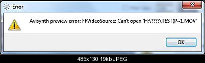

Unable to use the view information about the frame =(
PreviewAvisynth not understand Cyrillic letters in the directory / path > H:\тест\divx.hevc -

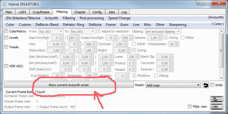

What does 'Show current Avisynth script' show? -

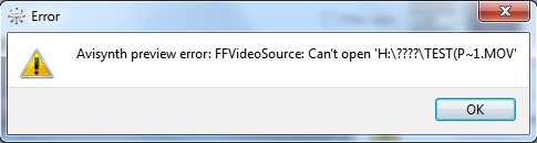

I asked: What does 'Show current Avisynth script' show?
I did not ask about the errors that come when you call 'Avisynth preview'.
Strange thing is, that for some unknown reason 'H:\тест\test (p).mov' and 'H:\ТЕСТ\TEST(P~1.MOV' are mixed, the debug output showed 'H:\тест\TEST(P~1.MOV', which normally shouldn't happen, so I'm trying to find the place where the processing is going wrong on your system. -

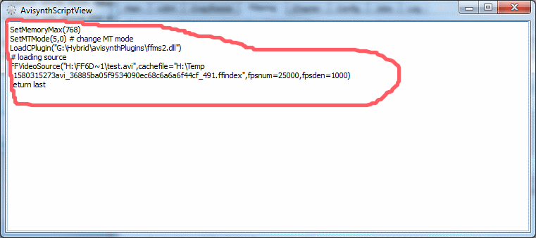

No, the problem is that .avs contains:
and the folder name is not made up of ANSI characters.Code:"H:\าลัา\TEST(P~1.MOV"
So to know where the problem originates I want to know how the script looks before it get's saved to the hdd.
-> see attachments -
Okay, there the script is fine. ('ТЕСТ' is used instead of 'тест')

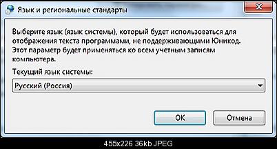

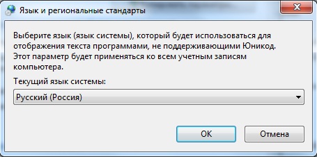

What language is selected under 'Control Panel->Region and Language->Administrative->Language for non-Unicode programs' on your system?
