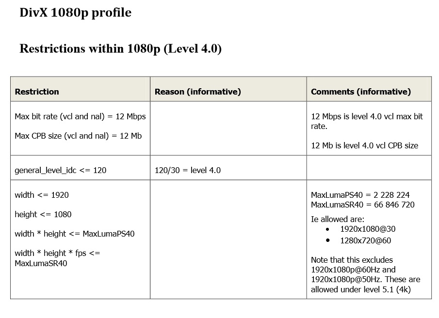

  22. Whether to hybrid obey the rule profile DivX1080p@30?
    Translator screwed up.
    Not sure what you want to ask.
    Atm. Hybrid only checks that
    a. the selected DivX-Resolution-Profile matches to the output resolution
    b. that only frame rate supported by DivX265 are used.
    it doesn't check the combinations mentioned on page 6 of http://labs.divx.com/system/files/DivX_HEVC_Profiles.pdf
    The 4K profile targets CE devices supporting 4K display resolutions up to 60 fps.
    1080p targets devices supporting 1080p resolution up to 60 fps.
    720p targets mobile devices with up to 720p resolutions up to 30 fps.
    and looking at these restrictions 1080p encodes are not limited to 30fps.
    (will add a check to validate that the output obeys these combination restrictions)

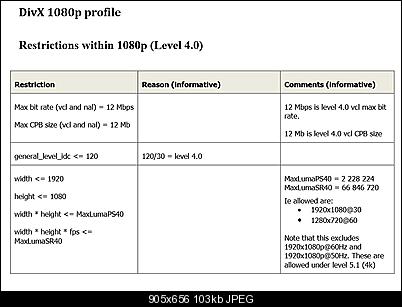

  23. Member
    Jan 2014
    Kazakhstan
    Table write 1080p@50 and 1080p@60 that is not supported for 1080p profile
  24. you are right, will adjust next Hybrid version accordingly to check that width * height <= MaxLumaPS and width * height *fps <= MaxLumaSR
