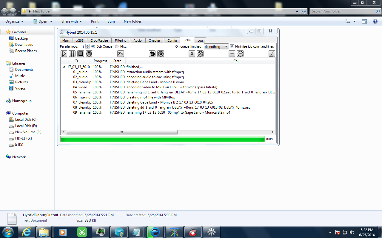

    i found a rather nasty bug with your software, version 6.15.1, namely i was trying to transcode some wmv to hevc with both x265 and divx, but they would both crash. that's not the bug though. when i went to look for the source file i noticed that it had been deleted and not to the recycle bin, but wiped out! i had to use recovery software to get it back. this happened twice. i finally realized what your app is doing, before calling the video encoder it's deleting the source, hence why the encoding crashes, since the source is deleted from the disk before it can be piped to the encoder.
    nasty bug.
  9. nasty bug.
    I agree, that really is a nasyt thing, the source should never be deleted.

  10. Banned
    Nov 2005
    ok, i just tried it again and again the source is deleted prior to attempting to encode the video, oddly enough this time there was no crash, an mp4 with just the audio was created. attached you will find a screenshot and a debug output.
  11. Please create a debug output which contains the whole process, the debug output you created only contains the job processing.
    The main points I need to see are:
    a. input analysis
    and
    b. job creation
    which are both not included inside your debug output.
    Also remember to not change the output folder from the default output folder, which you specified. (compare with http://www.selur.de/support)
    Cu Selur
  12. Banned
    Nov 2005
    how's this.
  13. That looks good and should help to find the code which caused the problem.
  14. Strangely I couldn't reproduce the issue here, but I made some changes and will send you a link to a new version for testing which hopefully will prevent the problem. If it doesn't please create a debug output with that version.
    Thanks!
    Cu Selur
  15. Banned
    Nov 2005
    this one works perfectly sans one thing, it gives me an error message during gui init about avisynth not being something, i didn't pay attention to it but it does start.
    encoding works as it should, but this version seems faster than previous versions for some reason. i also noticed you changed the gui, instead of reporting the encoding speed within the white area it now reports it at the bottom, much cleaner that way.
  16. The avisynth message appears when the installed avisynth extension version isn't the latest. (-> avisynth get's disabled)
    Happy the file deletion problem is fixed for you.
