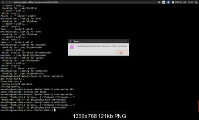

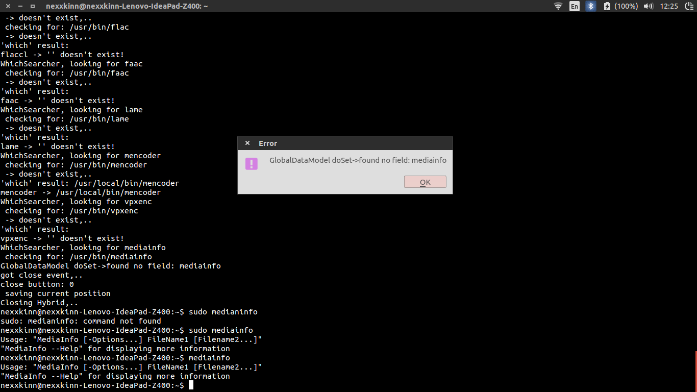

  1. help me this one
Name:	Screenshot from 2014-06-13 12:25:47.png
  2. @dicto: looking at the output it seems like you are on a linux system and you did not install all the tools Hybrid uses, http://forum.selur.de/topic124-info-hybriddependencies-for-ubuntu.html might provide some general hints (sadly most of the links there are outdated).
    There is next to no installer/packages or similar for Hybrid on Linux (aside from the Arch Linux package (maintained by hobarrera)), since I lack the time and nobody else cares enough to create packages/installers.

  5. Originally Posted by Selur View Post
    funnily, i didn't even get that error in the previous version, which means there's something wrong with your software...
    oh anyway, when i deleted .Hybrid files, i got that error.
  6. You might be right, but sadly you did not care enough to provide enough infos to reproduce the problem.
    I just tried the latest release (2014.06.08.1) on my typical linux test systems:
    - Ubuntu 64bit 10.04 (using Qt 4.6)
    - Ubuntu 64bit 12.04 (using Qt 4.8)
    - Kubuntu 64bit 14.04 (using Qt 5.2.1)
    - Ubuntu 10.04 32bit (using Qt 4.6)
    - Ubuntu 12.10 32bit (using Qt 4.8)
    - Ubuntu 14.04 32bit (using Qt 5.2.1)
    and none showed the error popup you made a screenshot of
    -> will guess without further information:
    Try if deleting the default settings folder: '/home/USERNAME/.hybrid/' as the problem might be related to some old defaults
  7. i'll try redownload mediainfo then..
  8. I doubt that, that will change anything, but by no means if it pleases you, do as you wish.
  9. ummm....what?
    1. extract previous version (140428) to home folder
    1a. delete .Hybrid folder on home folder
    2. run it through terminal
    3. error->because Hybrid detected my x265 folder on home folder as a program
    4. fine then, rename it...
    5. move Hybrid's previous files to document folder
    6. try to run the recent one with terminal
    7. it's running now
    8. "what?"
    oh anyway, when i checked the .Hybrid folder, i realised that the recent version didn't make toolinfos.xml when that error happened.
    so, i deleted .Hybrid folder and use previous version to make .Hybrid folders...
    lol, found the answer by myself... ~_~
  10. 1. extract previous version (140428) to home folder
    -> update to latest version, I always only provide support for the latest version
    (the mis-detection of folders as programs should be fixed with the current version)
