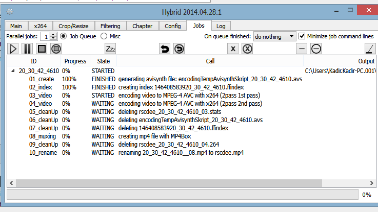

    it is stuck at encoding video mpeg
  7. a. Strange normally encoding should work. (works fine here)
    b. Send you a link to a version with aWarpSharp support. (recreate the job and then try if that also fixes your 'encoding not starting' problem)
    c. What other filters? Like I wrote mfToon is already there and that is the only filter you mentioned.

    sssss.avi
    please see the sss.avi it shows that it doesen't encode it stucks,

    Hi KaddirB,
    What OS are you using?
    Reset the settings : Config > Output "Clear all cathed tools infos" ? ; and it is desirable to provide a sample...

    @Gravitator im using Windows 8 i just have a third party theme installed yes i know it looks like mac again i tried this it is stuck idk why this happens is this problem only on me why does the previous version work yes one of the older versions did work everytime i instal newer version it seem to stuck not go.
  11. try the version I send you and make sure 'Filtering->Avisynth->Misc->Misc->Disable distributor()' is enabled, seems like for some reason Win8 users have problems when it's enabled. (got is always disabled on my Win7 machines and have no problems; had no problem reencoding your file)

    Sorry that did not work! i think theres something wrong with my pc etleast i think but theres no bugs nothing just stuck freezing now even the version that worked before doesen't work ugh it would be great if there was someone else same problem that knew how to solve but it seems useless is eather my pc or idk i tried everything unistalling reinstalling newer version older nothing stuck stuck.
