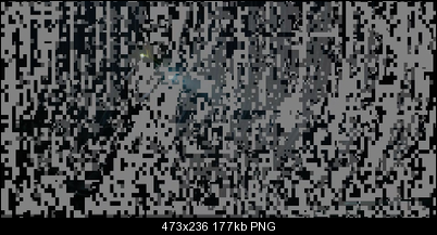

    Please note that the video files created by DivX / HEVC through Hybrid receive defective or something ...
    In the initial position when decoding with squares (as if starts P frames)
    The guy with the GUI for DivX is not noticed.

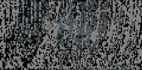

  10. Please note that the video files created by DivX / HEVC through Hybrid receive defective or something ...
    I can reproduce the problem, but I'm not sure if it's a bug in Hybrid or a problem with the decoding.
    Jan 2014
    Kazakhstan
    Any! It turns out the first frame of this and just do not notice at a fast speed (faster processor)
    That record
    Jan 2014
    Kazakhstan
    Maybe that does not adhere to the rules Hybrid when creating HEVC (first shots against the rules? I>B>P)
    When encoding or when packaged in a container there is an error
  13. Trying to reproduce find the source of the problem I used:
    1. mencoder->ffmpeg->DivX265:
    mencoder -lavdopts threads=8 -really-quiet -of rawvideo -o - -ovc raw -demuxer lavf -vfm ffmpeg -noskip -vf scale,format=i420 -forcedsubsonly -nosub -nosound -mc 0 "H:\PROMET~1.MKV" | ffmpeg -loglevel fatal -threads 8 -an -sn -r 23.976 -pix_fmt yuv420p -s 1920x1080 -f rawvideo -i - -r 23.976 -pix_fmt yuv420p -f rawvideo - | DivX265 --input - --size 1920x1080 --bitrate 1500 -aqo 3 --interval 5 --framerate 24000/1001 -o "H:\Temp\mencoder_21_25_04_1810_01.265"
    Result: first frame broken
    2. ffmpeg->DivX265:
    ffmpeg -y -loglevel fatal -r 24000/1001 -i "H:\prometheus(black).mkv" -an -sn -threads 8 -vsync 0 -r 24000/1001 -pix_fmt yuv420p -f rawvideo - | DivX265 --input - --size 1920x1080 --bitrate 1500 -aqo 3 --interval 5 --framerate 24000/1001 -o "H:\Temp\ffmpeg_21_16_11_8010_01.265"
    Result: everything is fine

    => seems to only happen with the first frame and your input file. (tested 4 other input files and they all came out fine)
    Won't change anything in Hybrid because of this since I got no clue why this only happens with your source file and not with others and why it only happens with mencoder. (conclusion for now: it's not a bug in Hybrid it self, but some sort of incompatibility of your source and mencoder, but I can't write a workaround for it since I have no clue what's triggering the problem <> what makes your sample special)
    Cu Selur

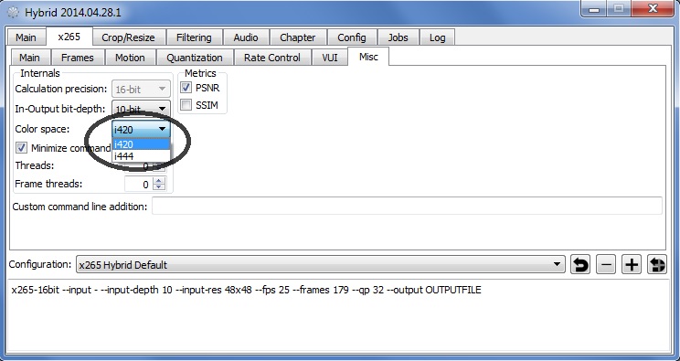

    @Selur
    I do not know if rightly understood the information Steve Borho? date Sun, 11 May 2014 22:09:22
    Command Line Options
    **CLI ONLY**
    option:: --input-csp <integer|string>
    YUV only: Source color space.
    Only i420, i422, and i444 are supported at this time.
    The internal color space is always the same as the source color space (libx265 does not support any color space conversions).
    0. i400
    1. i420 **(default)**
    2. i422
    3. i444
    4. nv12
    5. nv16
    http://hg.videolan.org/x265/file/e7f11c87d7db/doc/reST/cli.rst

  22. 1. afaik x265 doesn't support 4:4:4 encoding, try in a console if you like to know for sure.
    2. Not sure what you why you posted those meadiainfo outputs for the two files, both files are 4:2:2,....
  23. Selur
    Releases for us to test the Hybrid version enabling 4.2.0-4.2.2-4.4.4 (8 bit) and 4.2.0-4.2.2-4.4.4 (10 bit) to HEVC-265.
    The option is not enabled in Hybrid?
    You will put in the new version?
  24. You are right, I mixed up some stuff.
    -> yes next version will support 4:2:2
