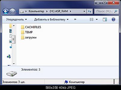

    does not have a file
  11. cut from the log and not even in quote- or code-tags => not useful at all.
    -> re-read: http://www.selur.de/support
    There definitly is something wrong, since:
    a. the output name shouldn't be xvid.mkv, but xvid_20_08_07_9710_02.mkv
    b. the output of the mencoder call should end up in the temp folder (like the stats file)
    c. that output should be deleted after remuxing with mkvmerge
    -> please provide proper infos which allow to reproduce the problem
    Cu Selur

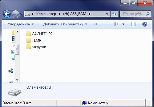

    Jan 2014
    Kazakhstan
    more in excess mentioned (the photo shows)
    detected free size (MB): 1253
  20. that just shows the amount of space left on the target drive, also a glitch, no problem
