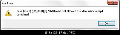

    is impossible to change the container to mp4 or mkv
    file > Sample

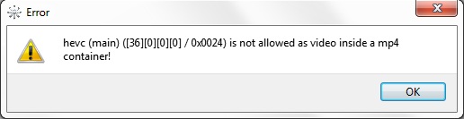

  7. I see the problem, instead of 'hevc' 'hevc (main) [36][0][0][0] / 0x0024)' is reported as format.
    -> will look at it, should be easy to fix
    (what OS are you using?)
    Jan 2014
    Kazakhstan
    Win7x64
  9. Argh, just found a small problem:
    tsMuxeR hasn't updated it's version string since 2.4.1, but only 2.5.5+ support hevc inside transport streams -> will have to move ffmpeg for the time being
    -> send you a hopefully fixed version

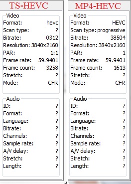

    Replaced MP4 container, and now the file size decreased from 131mb to 123mb
  11. Not that surprising, ts has a relatively huge container overhead.
    Jan 2014
    Kazakhstan
    But it is clear that the hybrid does not carry information from the original TS to MP4 (judging by the picture / frames, bitrate)
    and still various letters - one small and the other large ( format: HEVC - format: hevc )
