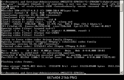

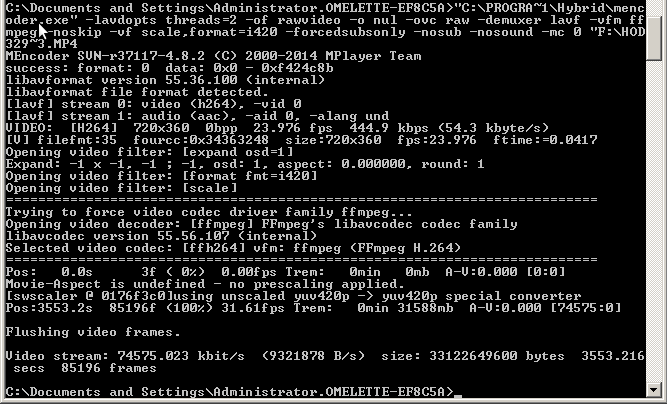

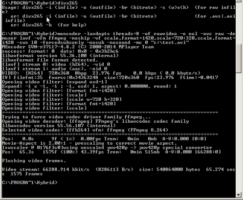

  20. Selur, first off, I have really no idea what that line is supposed to be doing - all those options make my head spin! Running it, I get a problem regarding the paths. Changing both paths to "c:\", so that it becomes;
    mencoder -lavdopts threads=8 -really-quiet -of rawvideo -o - -ovc raw -demuxer lavf -vfm ffmpeg -noskip -vf scale,format=i420,scale=720:320,scale,format=i420 -sws 10 -forcedsubsonly -nosub -nosound -mc 0 "c:\test.avi" | DivX265 --input - --size 720x320 --bitrate 1500 -aqo 5 --interval 5 --framerate 25 -o "c:\test_09_13_36_5710_01.265"
    it runs ok - meaning 'DivX265.exe' executes, then sits there doing nothing. I tried putting a valid 'test.avi' video at c:\ but it still does the same - so I guess that test.avi is not being used as an input-file. If you're confused, think how I feel!!! Probably redundant, but a little video of what I am seeing is attached.

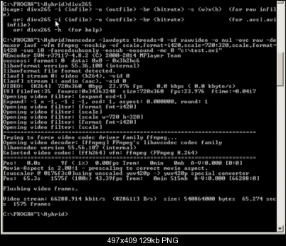

  21. What happens if you simply call (in a command prompt) the DivX265.exe inside the Hybrid folder?
    Do you get the normal DivX help output?
    To check if the decoding works fine, try calling:
    mencoder -lavdopts threads=8 -of rawvideo -o nul -ovc raw -demuxer lavf -vfm ffmpeg -noskip -vf scale,format=i420,scale=720:320,scale,format=i420 -sws 10 -forcedsubsonly -nosub -nosound -mc 0 "c:\test.avi"
    this should throw an error if mencoder has some problem decoding the file.
  22. Everything appears normal when I try both of those things (see pic).

  23. strange,..
    I send you a 32bit Windows build of my development version, which includes an additional ffmpeg passthrough to show progress during DivX265 encoding, did you try if that version helped?
  24. Sorry, didn't notice your PM. After replacing the Hybrid.exe file with the new one, I get strange(r) results! First, I get a "disabled avisynth support... need to update avisynthExtension AddOn" message - probably 'cos it's a development version. Now DivX265.exe actually does something, but only for 3% of the sample-video (1min of x264, 25fps), before going into hibernation-mode again!
    For what it's worth, to rule out a problem with my XP install, I created a fresh virtual-XP partition using a different & updated XP ISO to the one I used to create my old virtual-XP partition (which was a stripped-down to the bare-essentials version). It made no difference - which really didn't surprise me as Wine-XP has the same problem as well. Has me wondering if this could be a 32-bit/64-bit issue?!?!?
  25. need to update avisynthExtension AddOn
    my bad, should have refused to look at the issue until you updated to the latest version.
    -> clear the tools cache (under Config->Tools), deinstall Hybrid, download and install the latest version and replace the Hybrid.exe binary with the development version, then try again
