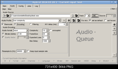

  2. @omelette:
    - reproduced and files the 'audio only -> Preview crash'-problem
    - can't reproduce the opus problem, probably because I don't know what you did before pressing Reset To Video Input' :
    what I did:
    • start Hybrid
    • load test.wav
    • set audio handling to 'custom'
    • enable Reencode
    • set audio format to opus
    • set bitrate to 32
    • added audio job to audio queue
      -> job was properly added with 32kBit/s as bit rate
    • removed the entry from the audio queue
    • changed audio to 'auto add (first)'
    • checked the audio queue
    • pressed 'Reset to video input'
    => no clue how to reproduce the problem you describe, atm. it looks like a usage problem not a bug.

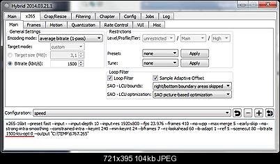

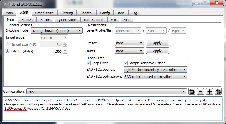

    Option does not work "SAO picture-based optimization"; it is not associated with the correct symbol / error on the command line? (in the picture parameter is not divided on the value of bitrate / no space)

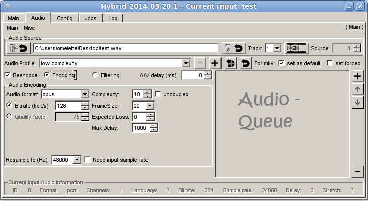

  6. @omelette: The dropDown-vairant is wrong! It Should be a spinbox. (like in the second screenshot; which it is always for me)
    -> please create Debug output level 9 (loading the source, switching to audio handling custom and selecting opus)
    @Gravitator: I see the '-lcu-op 0'-whitespace problem, the symbol choice seems fine.
    -> will fix
  7. Originally Posted by Selur View Post
    Really? The drop-down's I see would seem the better choice - buy hey, you're the boss! Please find attached the debug file (which includes selecting bit-rate and adding to audio-queue).
  8. dropdowns get only used, if the encoder only support some specific bitrate
  9. Originally Posted by Selur View Post
    Aha, I see, that makes sense. I presumed that Opus would only encode in the discrete steps I see in the drop-down menus, but after playing with 'opusenc' from the command-line, I see it will encode with any bit-rate - even with '--bitrate=1', although it won't play-back at this low bit-rate (2kb/s is the lowest that will play-back successfully with my 'test.wav' file).

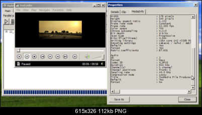

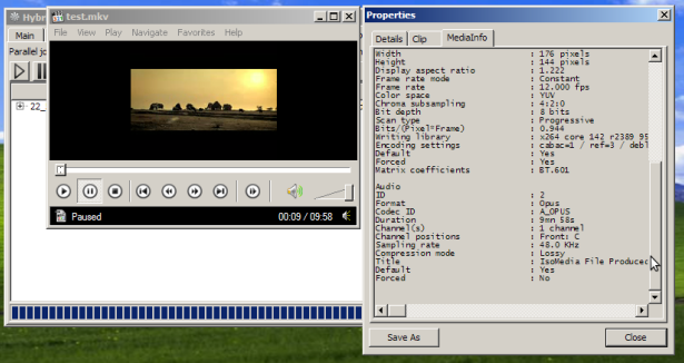

  16. What I'm seeing seems bizarre! What I've established so far:
    1. Opus audio-only re-encodes and plays-back successfully with both Media Player Classic and VLC.
    2. The problem ONLY occurs when Opus is involved - I can re-encode videos using acc, mp3, ogg audio without difficulties.
    3. Although there is no audio on video-playback, a single Opus audio track is contained in the mkv (see pic).
    4. I have listened to the temp Opus-file (found in Local Settings/temp before being deleted) immediately after it is created, it is correct and complete - but there is no audio when the mkv is replayed, just silence! - this strikes me as completely bizarre...
    5. Stranger still, when re-encoding audio as Opus if an audio file is present in the output folder, (wav-file, Opus-file etc. doesn't seem to matter, the file-name doesn't matter either, just the extension ie. *.wav, nor where the output is being written to) this becomes the video-playback Opus-audio!!! For example, my sample video is 9:58sec in length. My 'test.wav' is just 0:16sec in length. When I re-encode the video, the mkv-audio is listed as 9:58sec (as in pic) BUT there is only 16sec of 'test.wav' audio heard, then silence.
    6. Playing back the mkv produced, the current VLC complains "VLC does not support the audio or video format "undf". Unfortunately there is no way for you to fix this.", and continues with no audio. Wine-Hybrid and Wine-VLC also produces the same error.
    Could 'mkvmerge' be somehow corrupting the Opus-audio while merging???

    No, I haven't. I forgot to mention though, I tried loading the mkv file produced with AVS Video Converter - the audio-channel information fields are all blank. It has no problem recognising the Opus-format itself though. Neither has VLC, it's just the Opus-audio that's merged into the mkv file that is causing difficulties.
    My source file is a little 3gp Youtube video available here. Please note that the problem is not consigned to this video - thinking Opus was fixed, I initially re-encoded an entire 2hr movie with Hybrid, only to end up with the 16sec of audio that my 'test.wav' file contained!
  20. STOP THE PRESS!!!
    Damn, I've just downloaded the nightly-build of Media Player Classic and the Opus-audio works perfectly. I'm mystified as to how the mkv was ending up with completely different audio though! Sorry for the wild-goose-chase.
    PS - I worked it out - When the 'old' Media Player Classic can't work out what type of audio-track the mkv file contains, rather than use none, it searches the base-directory and uses whatever audio file it finds there as the audio-track. Rename the extension or remove the file and it no longer plays! Bloody annoying...
