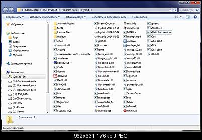

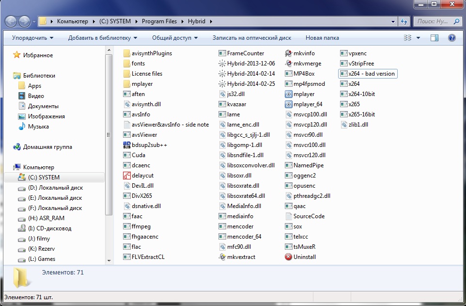

    a. you installed the 2014.02.25.2 - yes
    b. you replaced the x264.exe - yes
    but I got no clue that you did with the "2013.12.06.2" version - 2014.02.25.2.exe >replaced to> 2013.12.06.2.exe

    This is not the installers! himself "hybrid.exe" - I renamed them to avoid confusion
