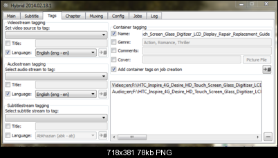

  19. Tagging does not work on latest version 2012.02.14.1
    Tried adding container tags, but whether encoding or simply muxing, tagging does not occur.
  20. Which container? What OS?
    Like always, see: http://www.selur.de/support
  21. I'm using Windows 7, the containers I've tried are mkv and mp4.
    Included debug file.
  22. will look at it

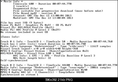

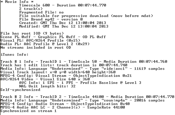

  23. What output do you get if you call:
    "C:\PROGRA~1\Hybrid\MP4Box.exe" -info "F:\HTC_Inspire_4G_Desire_HD_Touch_Screen_Glass_Digitizer_LCD_Display_Repair_Replacement_Guide_new.mp4"
    inside a Windows Command Prompt?
    It should look similar to:
    * Movie Info *
            Timescale 600 - Duration 00:00:17.183
            2 track(s)
            Fragmented File: no
  24. Click image for larger version
    This is what I see
  25. Did you test the new version I send you a link to?
    Also it's starange that there are no tags, since the muxing call from the DebutOutput:
    "C:\PROGRA~1\Hybrid\MP4Box.exe" -par 1=1:1 -add "C:\Users\INDEST~1\AppData\Local\Temp\HTC_IN~1.264"#video:fps=25:name=:lang="en" -brand avc1 -add "C:\Users\INDEST~1\AppData\Local\Temp\IID_1_~2.AAC"#audio:lang="en" -mpeg4 -itags tool="Hybrid 2014.02.14.1" -tmp "C:\Users\**********\AppData\Local\Temp" -new "F:\05_58_39_3710__03.mp4"
    should set the language tag for aucio and video
    ..#video:fps=25:name=:lang="en" ...#audio:lang="en"
  26. Yes I used that version, and no, I should have mentioned, the language tags weren't working either
    Was using MediaInfo before to check the tags.
    The same with mkv container
  27. What do you mean by that, looking at the debug output, you never specified more than the language tags:
    Video;;en;F:\HTC_Inspire_4G_Desire_HD_Touch_Screen_Glass_Digitizer_LCD_Display_Repair_Replacement_Guide.mp4
    Audio;;en;F:\HTC_Inspire_4G_Desire_HD_Touch_Screen_Glass_Digitizer_LCD_Display_Repair_Replacement_Guide.mp4;0;aac;2;passthrough;96;;auto;44100;;;0;464.77;aac;0;1;don't change;2;false;;false;1;false;;;;true;true;;;false;44100;unknown;;;false;true;false;2/0/0;1/1;;;;;None;;;;;;;;;aac lc;false;1;;;;IsoMedia File Produced by Google, 5-11-2011;;;;;;;

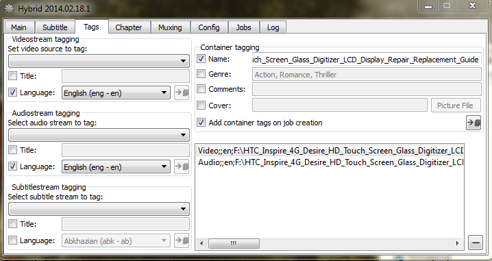

    Did you may be, fill out the elements under Container tagging, but did not press the "Tags->Container tagginsg->Add to tag list"-button?
    Cu Selur
  28. Click image for larger version
    Whether I click the button or check the box to add container tags on job creation nothing gets tagged.
