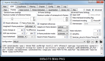

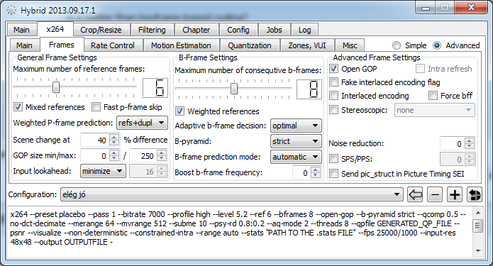

    Where can I find the Periodic Intra Refresh (instead of keyframes) in the x.264 options? Is it better than keyframe based coding?
  12. Where can I find the Periodic Intra Refresh (instead of keyframes) in the x.264 options?
    "x264->Frames->Advanced Frame Settings->Intra refresh" (if it's disabled, read the tool-tip for it's requirements; iirc it requires b-pyramid to be active)
    unless you use a real streaming environment, I would say: No
    (wouldn't normally encourage anyone to use it)

    And How?
  14. I forgot to write into the tool tip, that intra refresh requires 'Maximum number of reference frames' to be one. (since there are no idr frames that could be used as reference )
  15. @deadrats: I had no problem loading your sample (post #270) into Hybrid and reencoding it. -> Please create a debug output (level 1) of the source analysis.
    @johns0: made a test version with a 'Set chapters every X key-frames' option (requires: Config->Internals->Handling->Collect key frames to be enabled before the input is loaded to work), haven't tested it much, but seems to work.
    @Stears555: extended the tool-tip for the next public release to include the " 'Maximum number of reference frames' needs to be one"

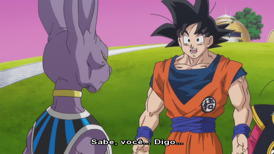

    I did a test with Hybrid / Hevc / Divx last movie Goku and I was impressed with the image quality between the original film, then compared with the conversion by Hybrid / Hevc / Divx. I know it is a simple visual test but has demonstrated a gain in quality altissimo, compression and vivid colors.
    I'm looking forward to testing the new variants of filtering that will come around, where the end user will surely be amazed with this new phase of this beautiful encoder (Hybrid / Hevc).
    Here's the info and screens tests obtained:

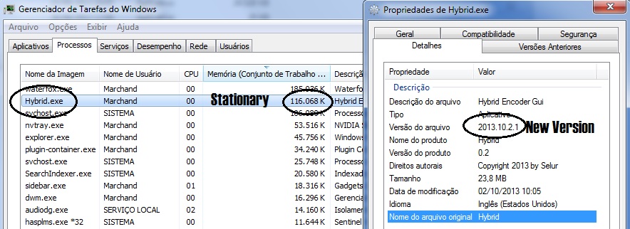

  26. Selur.
    Hybrid downloaded Windows Packages *: (not needed if the installer is used) rev 2013.10.02.1 (32 and 64 Bit) and both were static / stationary when the test went.
    Then reverted to the version of the executable Hybrid (09/17/2013) and it started functioning normally. I do not know what's wrong with the new version? Still have not tested the version with automatic Installer, but I believe that also will give error.
    In reversing the executable, this message appeared:
    Hybrid: homepage
    Forum: public forum
    Regarding problems please read: needed infos
    Donate: via PayPal
    Saved GlobalDataModel, base version: 130724
    Saved ChapterModel, base version: 111007
    ->disabling fhgaacenc support since the supporting libraries are not installed,...
    ->disabling qaac support since 'Apple Application Support' is not installed,...
    Finished initialization,...
    You must change avisynth Extension to 20130927 ?
    I do not know if this is happening to me that freezing new version?
    PS: I downloaded and tested the automatic installer and was also static in the new version. Updated avisynth and nothing?
    Selur

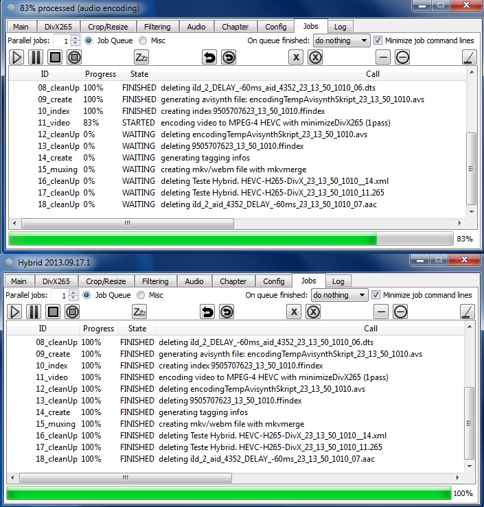

    I did a quick test and the Hybrid version (17.9.2013) (+) update avisynth Extension to 9/27/2013 and their settings (+) mkvtoolnix 6.2.0 v1.0.4 rovi promised land, is working perfectly.
    SCREENS:

    Te new version of Hybrid was unable to start after installation. (OP SYSTEM: Win7 SP1 x64)
    The problems were caused by:
    CUETools.FLACCL.cmd.exe KERNELBASE.dll
  30. argh, delete the CUETools.FLACCL.cmd.exe
