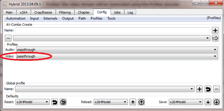

  7. I wasn't talking about the 'video handling'. Of course i've set it to x264 before tweaking the x264 settings. Obviously, the tooltips explain those options very well, just like Handbrake.
    When i said 'passthrough', i meant the one under the Config>Profiles tab.
    http://img202.imageshack.us/img202/8673/hyb.png
    Is it necessary to set it to something other than 'passthrough' even after setting 'video handling' to x264.

  8. The AV-Combo Profiles are ment to combine existing specific profiles.
    So unless you saved your x264 settings into an x264 profile you can't select it there.
    If you apply a AV-Combo-Profile with Video->passthrough, Main->Video handling will be adjusted to 'passthrough'.
    If you apply a AV-Combo-Profile with Video->'your custom x264 profile', Main->Video handling will be adjusted to 'x264' and your profile will be loaded.
    Cu Selur
  9. Okay. But what i was asking is, what should i set it to, if i don't want to use AV-Combo-Profile.
    I don't have any saved profiles. Now, can i set it to 'ignore' and then set video handling to 'x264'
    Will the ouput then use the x264 compression?
  10. If you don't want to use AV-Combo-Profiles, simply don't use them. Av-Combo-Profiles will only be used if you apply them by pressing the apply button on the main page.
    If you want the output be be compressed with x264, simply select x264 under Main->Video handling.
    Cu Selur

  11. Av-Combo-Profiles will only be used if you apply them by pressing the apply button on the main page.
    Thank you. That solves my doubt. Could you just point out where this apply button is, so that i make sure i don't mess with it.
  12. The mentioned apply button is not visible unless AV-Combo Profiles exist.
    Attached a screenshot which shows the button if it exists,...
