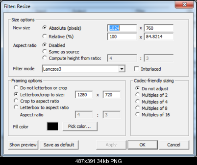

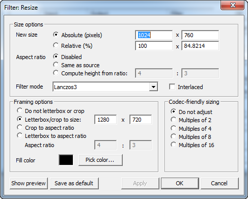

    Hello guys,
    I have a terrible doubt.
    I'm
    wondering how I can resize a video at 1280x720, but inside I want 1024x760.
    In
    virtualdub I can do it. See below.

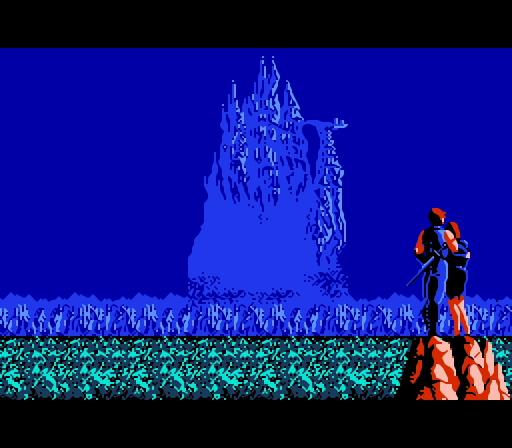

    My input file looks as:

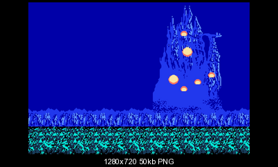

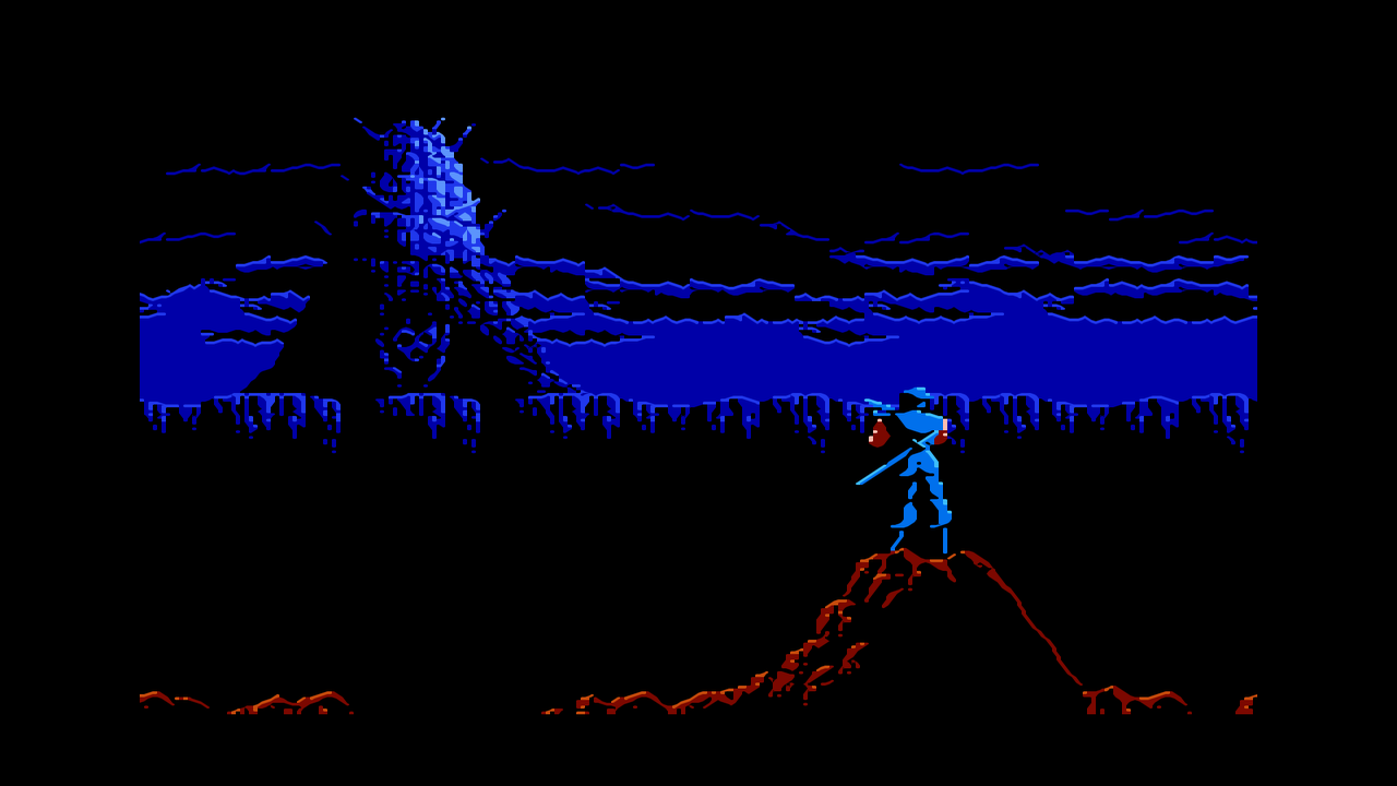

    After Virtualdub my image (desired) looks:

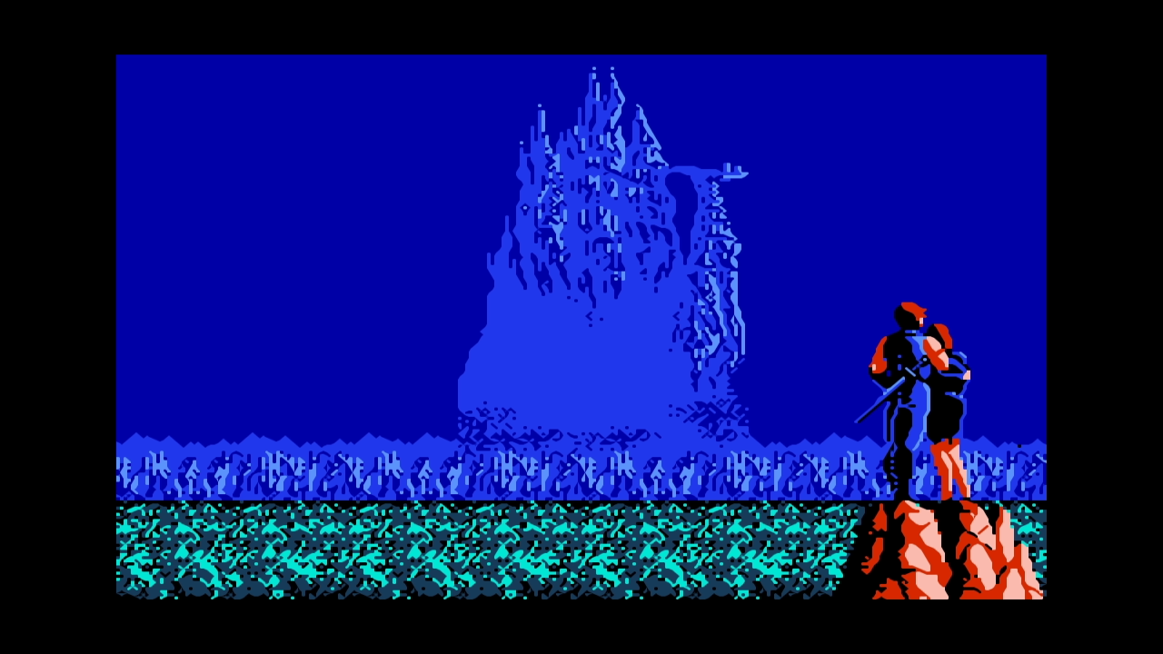

    Thank you for help jagabo but your config crop my video, look:

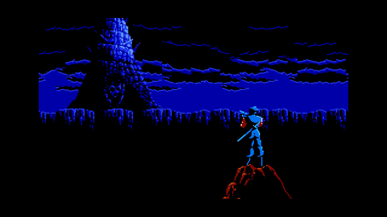

    Read MEGUI docs I find this:
    addborders(128,100,128,100)
    Lanczos4Resize(1280,720) # Lanczos4 (Sharp)
    Its work for me.

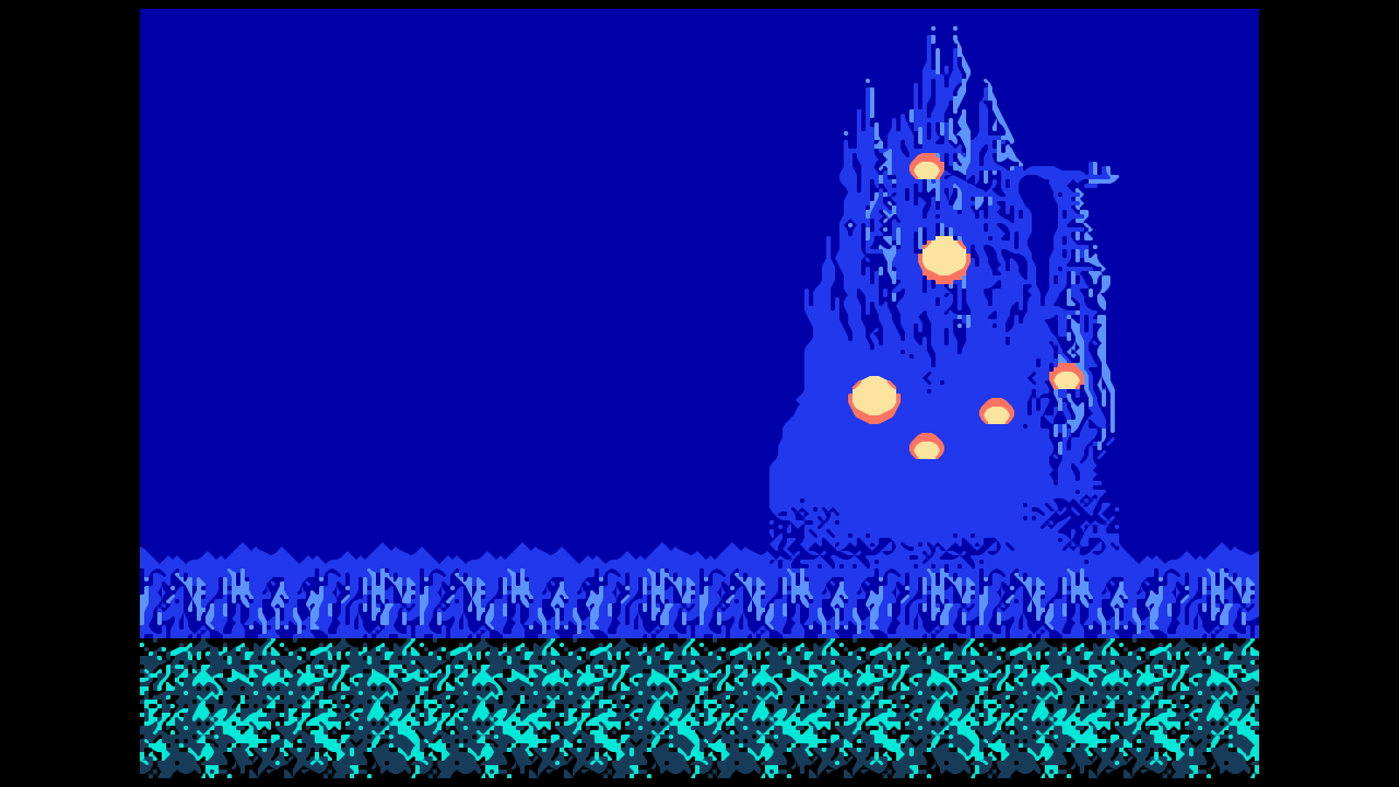

  4. It worked perfectly with the source image (1024x896) in your first post.
    How am I supposed to know what's right if you don't post the correct source?
