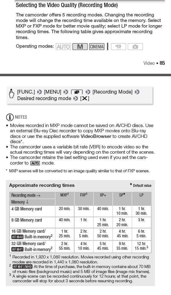

  19. Fox, you say: "I didn[']t found [find] any option in the cam to record in 1920 x 1080".
    But your camera specs say this: AVCHD - 1920 x 1080 - 24Mbps - require SDHC Class 4 or higher ¦ AVCHD - 1920 x 1080 - 17Mbps - require SDHC Class 4 or higher.
    Maybe your card is not a class 4 or higher therefore the camera will not shoot in those modes until you get a class 4 card.

    I record on M41's built-in flash. I can choose between different quality presets, but they just vary in bitrate. No 1920x1080 there afaik.
  21. Look in the manual. Look for video specs and see if the specs I mentioned is there. Your supplied SD card probably is not a class 4 so the camera ignores those specs until you purchase a class 4 (or better) card.

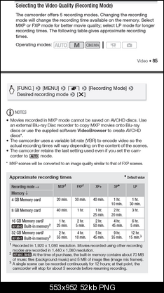

    you have to put the camera into manual mode, then the settings for video recording quality are available.

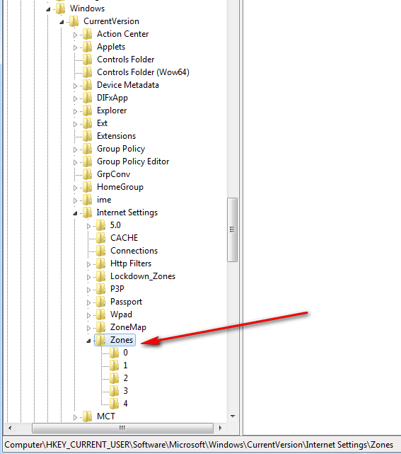

    I tried to install Corel Video Studio Pro X4 on my computer. But it doesnt work. It crashes with Error 135 during installation. Alot of users have that problem. Corel knows it, but they do nothing against it. Seems like they dont wanna make money with their software.
    try this fix. open up the registry key shown below. if there is a "zone" listed before 0 then you need to delete it. it is blocking certain installers. it was most likely installed improperly by an adobe reader update.
