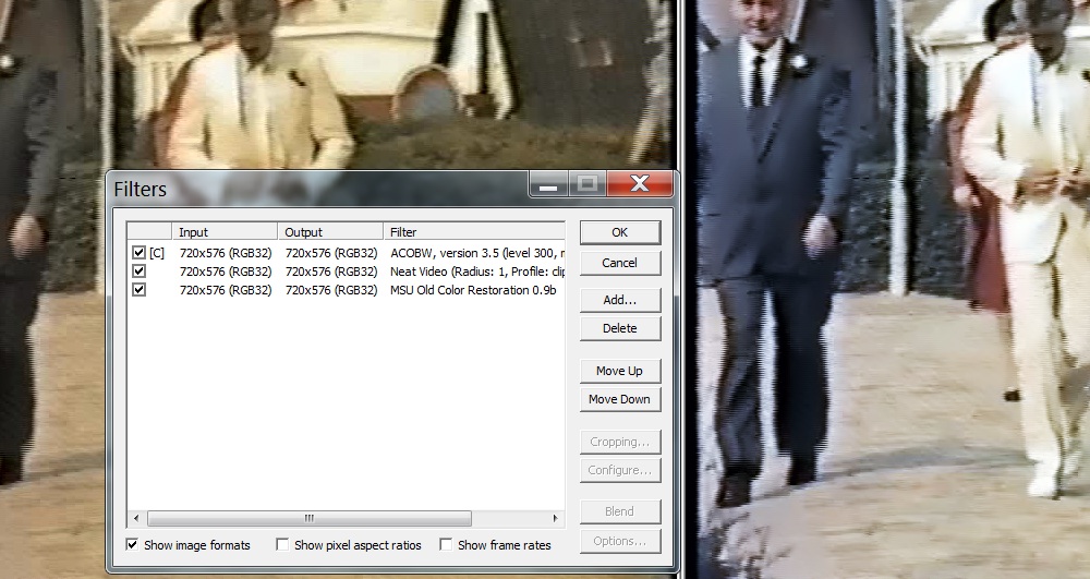

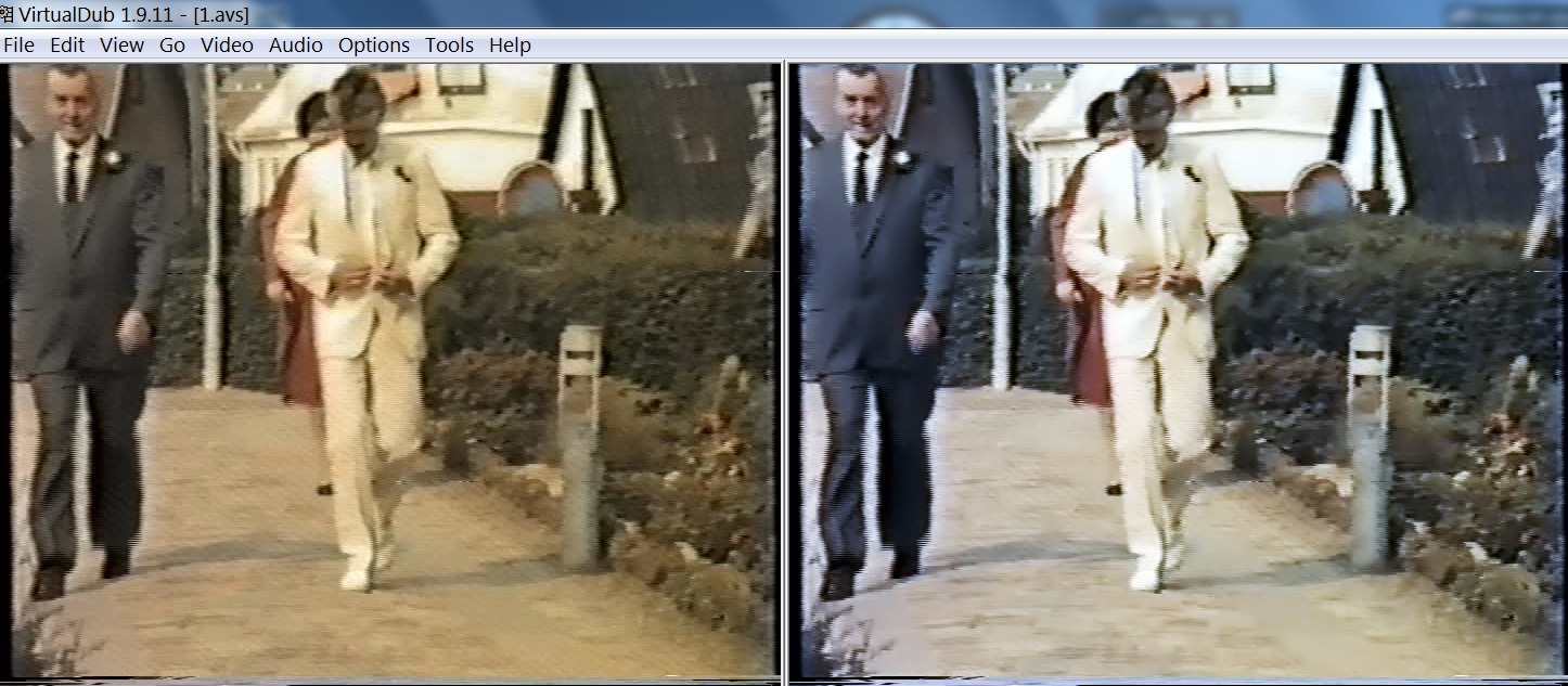

  11. Clean and simple only 3 filters nothing more and much better

    Mammo > That looks nice... But that neat filter is one you need to buy isnt it??? I can only find a trial version of it

  15. excorsist ?! no go you don't have ghost in the image at all and all others big no go, noise you may try neat video has demo version and is the "best" ( I know guys there is no best thing don't kill me ) color correction can be better done in sony vegas but it need some knowledge

  17. Look at the left mans tie it has waves a lot and it has stair steps ( that is tbc errors i guess ).

    Yes about the colors msu old color restoration filter used here ( i used it because to just show him what can be done if used properly ) it has tendency to over process colors and make them more hard ( wich i also dont like and don't use and can some times lead to psychedelic colors )

    That acobw filter where did you get that ?? Cant find it anywhere

  23. Google buddy just 2 sec more
    http://acobw.narod.ru/
    it is automatic correction of white balance
