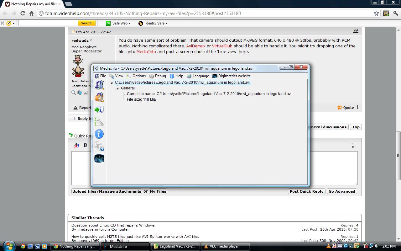

    You do have some sort of problem. That camera should output M-JPEG format, 640 x 480 @ 30fps, probably with PCM audio. Nothing complicated there. AviDemux or VirtualDub should be able to handle it. You might try dropping one of the files into MediaInfo and post a screen shot of the 'tree view' here.

  8. heres a screen shot from media info
Name:	screenshot of aquarium avi.jpg
  9. i just tried xmediarecode but it cant even open up the file i need help on how to repair it i will attach the video file if anybody can repair it please let me know asap
