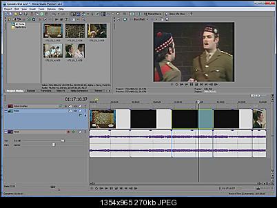

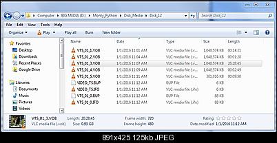

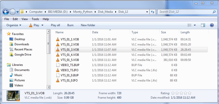

    In the screen shot you can see that Windows is getting the media length wrong. So does VLC. But I can play the VOB files correctly in PowerDVD 10.0. I still have no idea how the incorrect length is calculated.

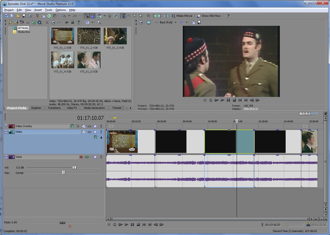

    Before restoring the metadata files, Movie Studio used the same incorrect lengths as Windows Explorer. Having restored the metadata files and re-importing, Movie Studio is getting the lengths correct!
    The incorrect length comes from the fact that in a studio DVD, even though the VOB file is indeed an MPG2 video stream, it is not necessarily contiguous. It is broken into cells, and the cells do not have to be in order. They don't even need to be in the same VOB file, since the DVD player sees it as one big block of data, not as several separate 1GB "files". The IFO file tells the player the exact physical location of the beginning of the next cell to play. So the first cell played may be at the beginning of the first VOB file, and the next cell could be at the end of the 3rd VOB file. Disney is also notorious for inserting dummy cells in the IFO file for which there is no corresponding video data anywhere on the DVD. A DVD player ignores them, but if you try to rip the DVD, it will fail because of those dummy cells.
    Windows, on the other hand (along with other programs such as Sony Vegas Movie Studio), expects to see a contiguous video stream like what would be found in a standard MPG file, so it reports the length that the VOB file tells it to. So your VOB file might actually have 25 minutes of video data in it, but Windows might report it as 30 seconds or as 12 hours.
    If you're using a program like Sony DVD Architect to create your own DVD from your own MPG file, it doesn't utilize all those obfuscation techniques. The cells are all in order, so the resulting VOB files actually are a contiguous video stream, and they really do report the correct length to Windows.
