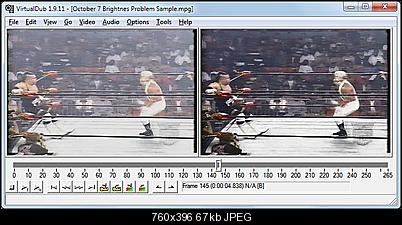

  1. I usually use "Cont" and "Bright" to fix brightness issues but this particular clip has a weird brightness issue that I don't know how to fix: http://www.mediafire.com/?x914mjgp6kexk4g
  2. Reduce gamma. It still won't be great because of the crushed brights.
    You might be able to tease out a little more detail with gradation curves.

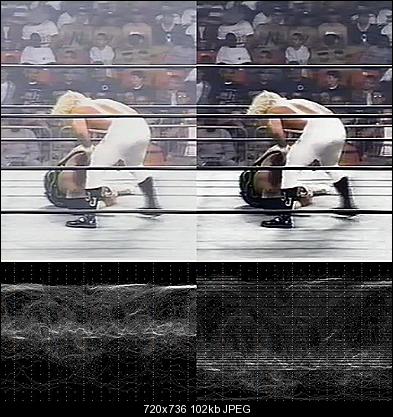

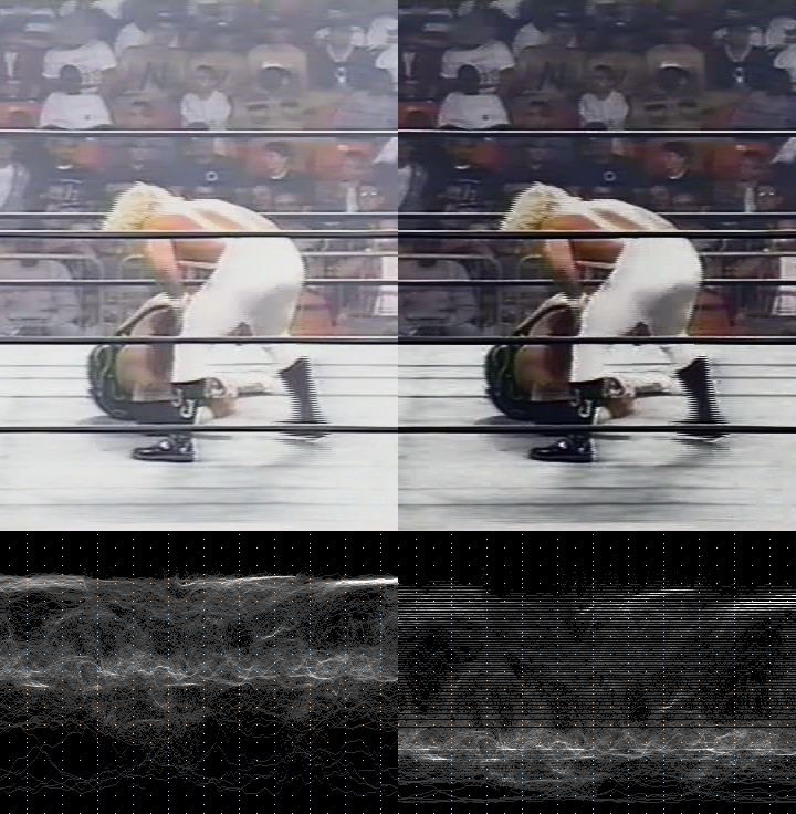

  5. before and after ColorYUV(gamma_y=-150, gain_y=20, off_y=12):
    Tune to your liking.

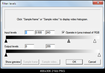

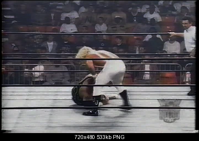

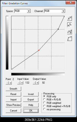

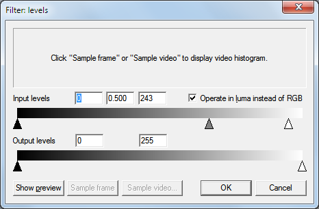

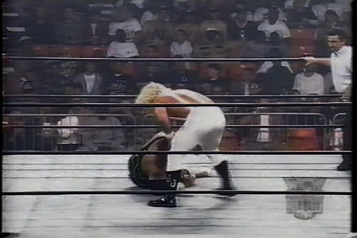

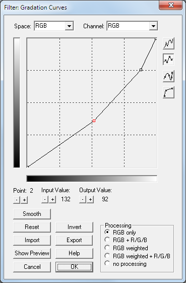

  14. I used levels and gradation curves in VirtualDub and got a little more detail in the bright whites:

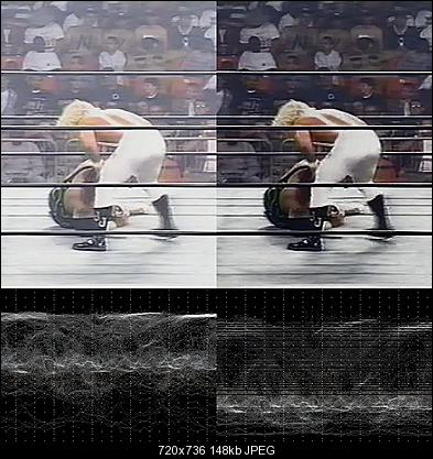

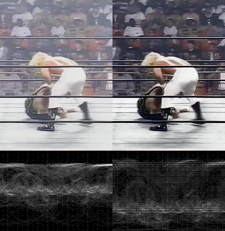

  18. Originally Posted by holygamer View Post
    Thanks but I did mention in the title that I wanted to fix it with Avisynth.
    You can call virtualdub filters from avisynth.
    A little further into the gamma?
     ColorYUV(gamma_y=-230, gain_y=-170, off_y=178)
