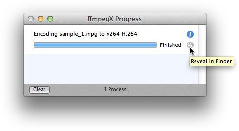

During conversion, the progress is shown in a separate window. When the conversion is done, the window should indicate such as well as alert you to it by sound. When the conversion is done, a magnifying glass icon should appear. This icon acts as a button to reveal the output file in the Finder, by opening its parent folder.
Thanks. Progress window gives out alert sound and indicates finished however there is only an x and not a magnifying glass. when i click the info button this is what comes up:
*ERROR: [mencoder] Level must be 'main', 'm', 'high' or 'h'
