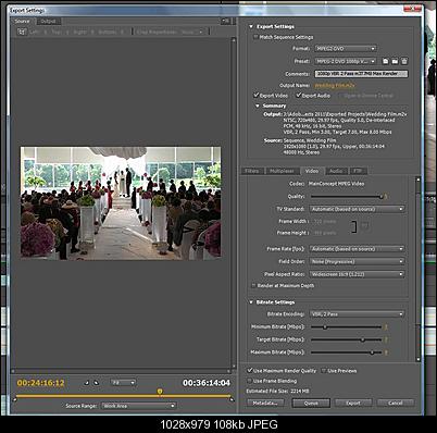

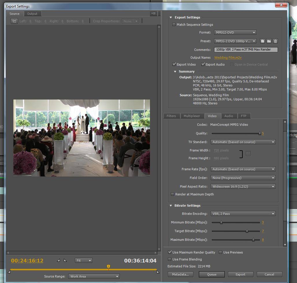

    May 2012
    Chicago
    I've spent the past few weeks tearing hair out (not really) trying to get good DVDs from my finished projects which are all shot and edited in AVCHD 1080 interlaced. The Blu-rays all look gorgeous, but the DVDs, well, not so much. What I found exasperating was if I sent the timeline to Encore and set it for best quality, with Max Render, not only are the encoding times long, but the results were not good. Lots of jagged lines on all angled objects. It just had a blocky look to it. And what was ironic was, if I took the time line and converted it to an mp4 file, then converted that mp4 file to a DVD using ConvertXtoDVD I got GREAT results! But ConvertXtoDVD doesn't offer anywhere near the level of Menu building that Encore offers. So it seemed when it came to DVDs, I was stuck with either mediocre footage or mediocre menus. (I provide both Blu-ray and DVD end products to my clients, but some of them don't have BR players yet, so the DVDs need to be good, too.
    I did find it pretty ridiculous that big, bad Adobe Encore was getting bested by a little program like ConvertXtoDVD!
    But I finally found the reason for the bad, blocky looking footage on the DVDs produced with Encore, and the solution (at least in my situation):
    Left to its normal settings, Encore wants to produce interlaced DVDs with Lower Field scanned first. But AVCHD interlaced has Upper Field scanned first. I think that is what was causing the jagged looks and blockiness in my DVDs. I've found that by avoiding using Dynamic Bridge from Premiere to Encore, I can tell Encore to convert the interlaced footage to progressive. The encoding still takes a LONG time for it to do it, but the results are great. And on the next DVD I make, I'm going to turn off Max Render to see if the quality is still good enough (I've read that Max Render really slows down the process). Maybe I'll even drop down to VBR 1 pass.
    Here are the steps:
    After completing the editing, Export as Media (don't use Dynamic Bridge).
    Choose MPEG-2 DVD and adjust your Bandwidth appropriately (I use Min 3, Target 7 and Max 8 Mb/s as long as it doesn't make the files too big to fit on a DVD).
    Under the Field Order tab, set it to Progressive (it's possible that I could just choose "Lower First" and get good interlaced quality but I'm not sure changing field order from the source footage is a good idea, and I KNOW that changing it to Progressive is giving me good results - aybe when I have an extra 3 hours to do an extra DVD I'll check those results out).
    Do the export
    Open Encore and import the m2v and wav files you exported out of Premiere and proceed as normal.
