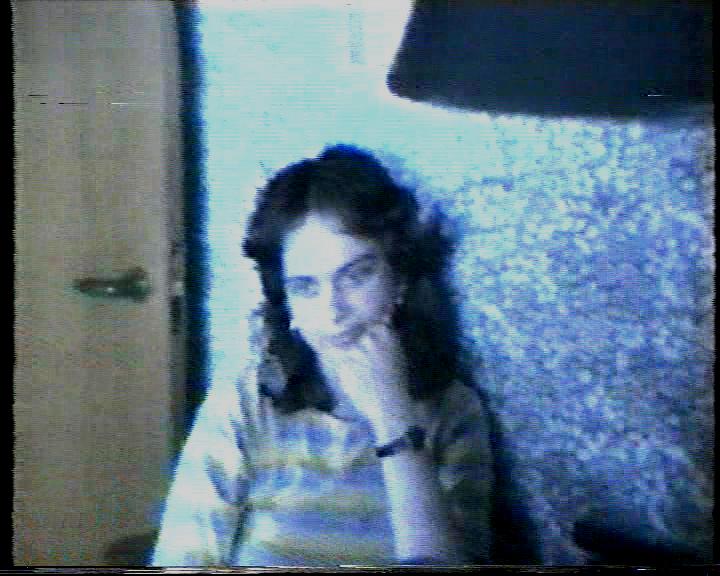

  23. The ideal settings vary depending on your source. The first thing you need to do is change the brightness and contrast settings so that the bright areas are not totally obliterated like they are now. Using a frame from your video that's not blown out:
    Here are blown out brights like you are getting in most of your clip:

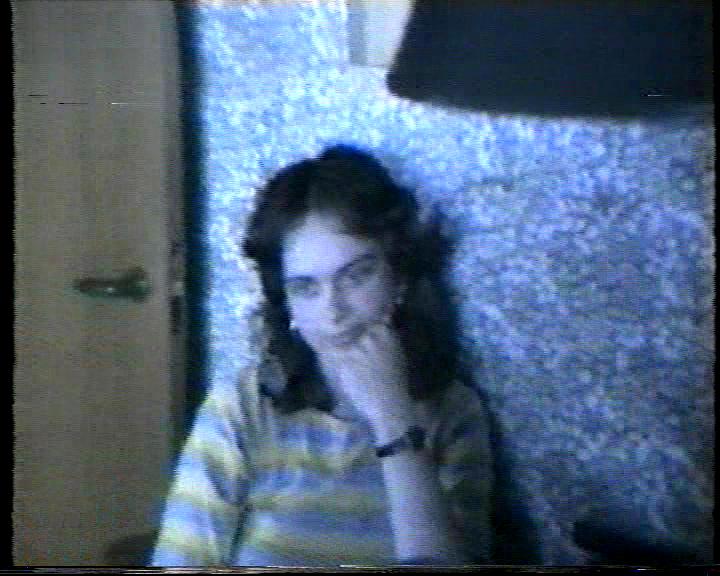

    Details in those very bright areas in the woman's face can't be restored when they're way too bright like this. You can darken the image but the blown out areas still won't have any detail:

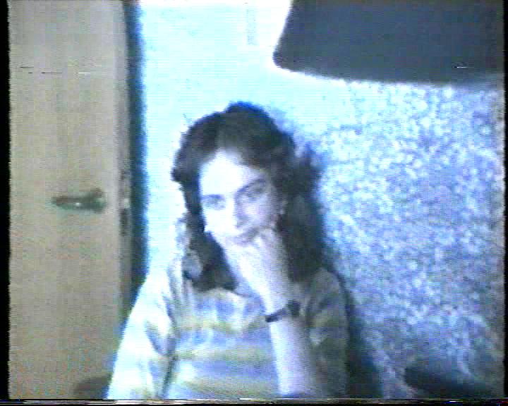

    Ideally, you want your caps to look more like this:
    Now there are details to work with in the bright areas of the woman's face. The darker areas are getting close to black. The brighter areas aren't blown out.
    It's possible that the bright areas are already blown out on the video tape. If that's the case adjusting the proc amp controls may not help. That's why people have been asking if the tape looks the same when watched on TV.
