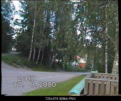

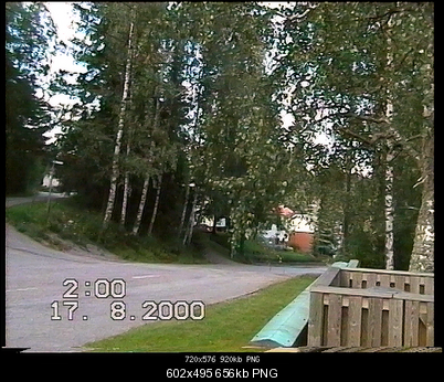

ID:	21409Click image for larger version
    Ok, so here the pictures. On on the bottom is the one with the TBC on. They are both the raw capture with a deinterlace filter.

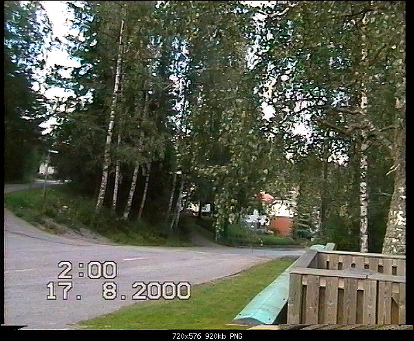

  10. Member Deter's Avatar
    Dec 2007
    #1 do not deinterlace an interlaced video.
    #2 You need to set your VCR in edit mode on the edit/detail switch and use the sharpness slider bar to set the VCR to the levels you want.
    #3 PAL tapes have a better picture than our NTSC stuff
    #4 The color change is not that bad, you will find if you press stop and re-record the picture three times the color levels will be different each time. Sometimes even a break in the tape will cause a color shift or change. (I would always try to capture in 1 shot meaning never press stop and would also do more than 1 recording)
    Doing 2 takes of the same video using a Panasonic:
    You will get two different shifts in the color, so if it was reds in the picture, did three frames from take #1 and three frames from take #2 and did this for a minute would have all kinds of flicker.
    For your pics it looks like a slight shift in the Black Levels & also Sharpness. (You don't need to get your VCR fixed for this, it is normal) If you set your sharpness levels on the VCR that problem is gone.
    If the colors are flat and fading to no color, yea than you have a problem.
    Lets say you have a cut in the tape which causes the recording to shift way out, than just redo it again until you get the colors to kind of match. You have a few tricks with using the VCR to get this right, it is too much to write out.
    Last off you can than later make edits to how you want the colors to look, here is just a few adjustments to the bottom pic and you can see it looks different. (I didn't adjust one color setting)
