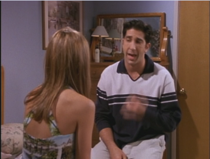

  5. This is an example of combing in my file. This will be followed by another similar interlaced frame and then 3 progressives:

    Yes this cap shows fields from different frames.
