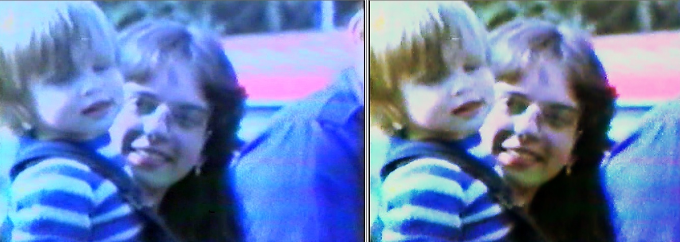

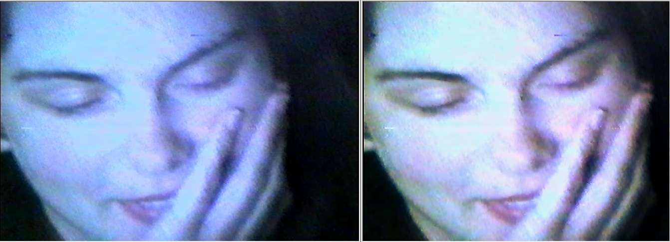

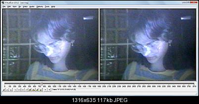

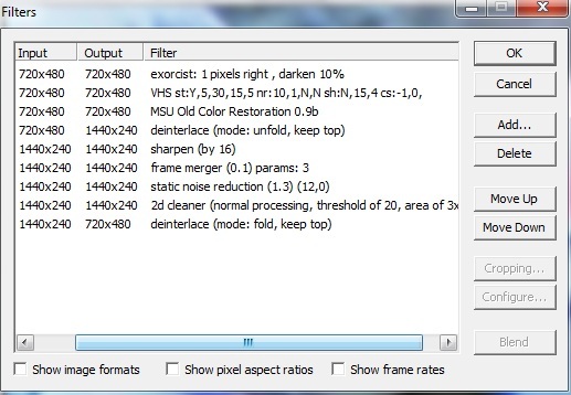

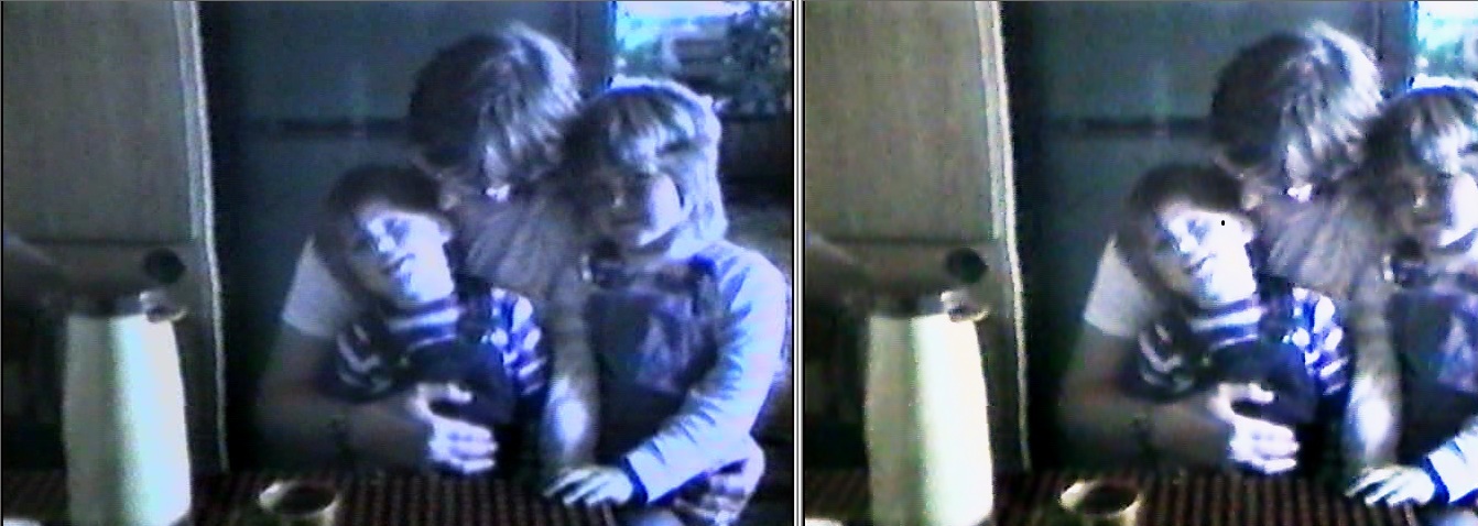

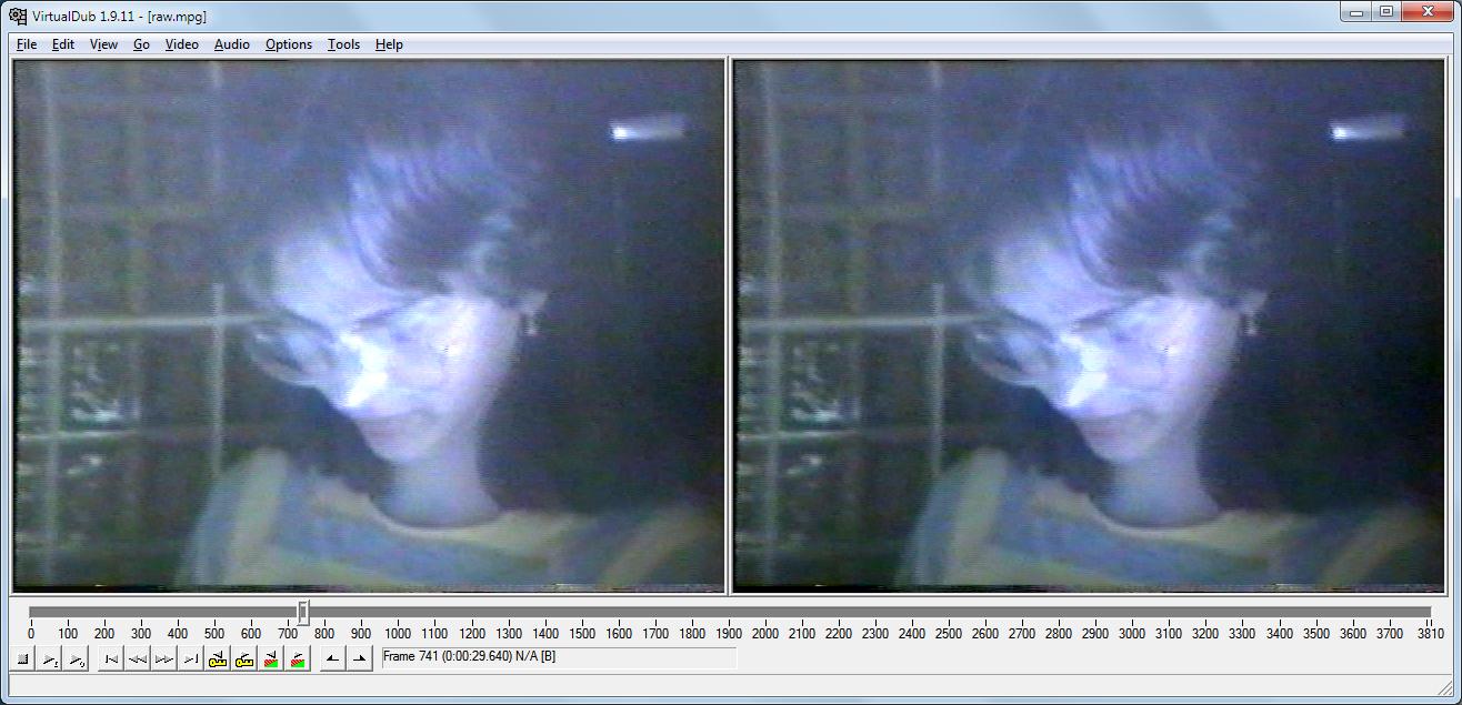

    Ive found a list of filters to use in here in a previous post about this, and it has helped, but i would like more, but is that possible???
    ive posted screen dumps of film and off the filters ive used... anyone have a idear for improvement??+

  3. Member 2Bdecided's Avatar
    Nov 2007
    If those are before and after shots, I'm sorry, but I think you've made it worse. The horrible clipping is now even worse. See those areas of bright flat colour where all the detail (and even all the noise) has gone?
    While it's probably clipped on tape, it's become even more clipped during capture, and even more clipped again when you've processed it.
    I think you need to fix the levels before capturing - and/or be more careful with YUV>RGB conversion levels.
    Cheers,
    David.

  10. Member 2Bdecided's Avatar
    Nov 2007
    This is what you have...
    http://www.mediafire.com/i/?s4qh3h3r7jimoe4
    ...this is about as good as that will get...
    http://www.mediafire.com/i/?ys51si8o1fts6sy
    Your capture device has completed misunderstood this old video and wrecked it. It's made it way too bright - and everything that was above maybe 75% brightness in the original (about the level of human skin tones in a properly shot video), has been converted to 110% brightness in your captured version. So all the details in the face have been converted into a single very bright colour. That's what "wrong levels" means. All the information in the brightest part of the original video has been completely lost.
    You need to re-capture using something else. You can't do anything useful with this capture. It's hopeless.
    btw (apart from the terrible capture) this doesn't look too bad for a home movies from the late 1970s/early 1980s (?). Capture it properly, and the colours can be corrected, the noise can be removed etc and I bet it'll look pretty good (for the age).
    Cheers,
    David.

  15. Banned
    New York, US
    [Attachment 11679 - Click to enlarge]
    Are these the only filters you used? None of the filters shown here are color correction filters (the MSU plugin is a special-effects filter). Try ColorMill and VirtualDub gradation curves.

  25. The problem could be in the VCR too. Try a different VCR. Even worse, it could be on the tapes. Are these second or third generation copies? If so, get the original tapes if you can.
    Another thing to try: adjust the video proc amp settings (brightness, contrast, hue, saturation) in your capture software. You might be able to get the levels down to a reasonable level.
    If you are stuck with these caps, the very first thing you should do in VirtualDub is pull the brightness down 8 percent with the Brightness/Contrast filter. That filter can work in YUV and pulling down the brightness there will bring out a little more detail at the high end. Then you can start working on further fixes. Brightness -8 percent:
    Notice how there's a little more detail on the cheekbone.
