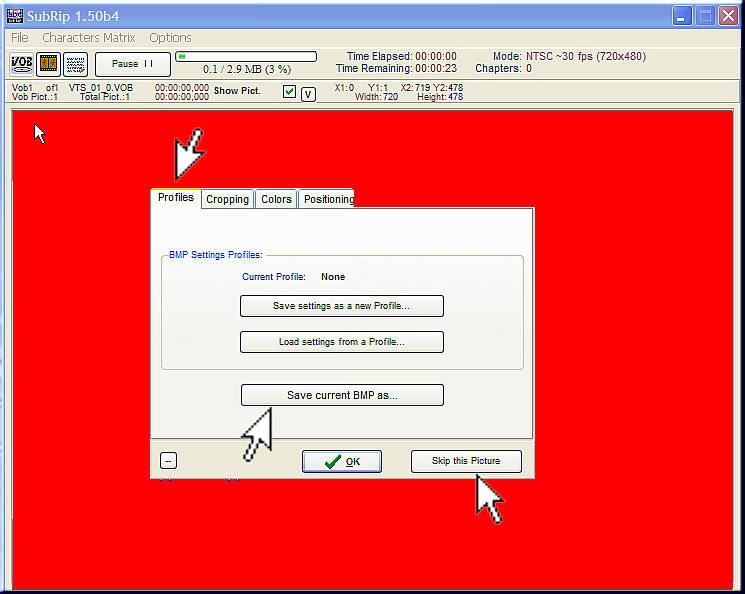

    Your setting is OK.
    Once the window open you have to save .BMP, than on next window, click on Profiles and there you can save each subpicture or skip to next one
    [Attachment 11719 - Click to enlarge]
    Feb 2008
    Brazil
    Originally Posted by tinker View Post
    Your setting is OK.
    Had already figured that out.. thanks anyway!
