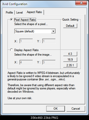

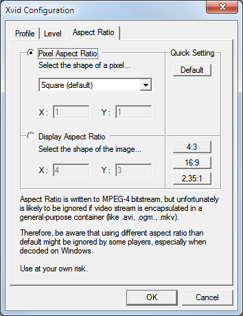

    In Xvid you use the PAR/DAR settings:

  13. Thank you Why do you choose x264 rather than Xvid?

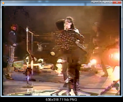

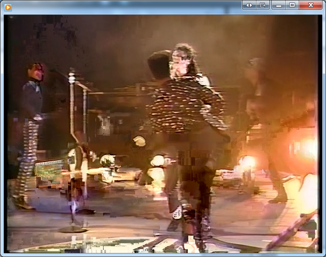

  25. I tried to render some tests as you advised, but I have a problem..
    When playing the encoded video with windows media player (VLC is fine). The video get highly pixelated like it can't read well the format.

  26. The sample looks fine here. You probably have a problem with the DirectShow MP4 reader/splitter and h.264 decoder. Try using MKV. See if that works any better. A quick remux with mmg attached.
  27. yes, it works using mkv. Thank you.
    Here was the problem with wmp:

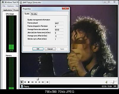

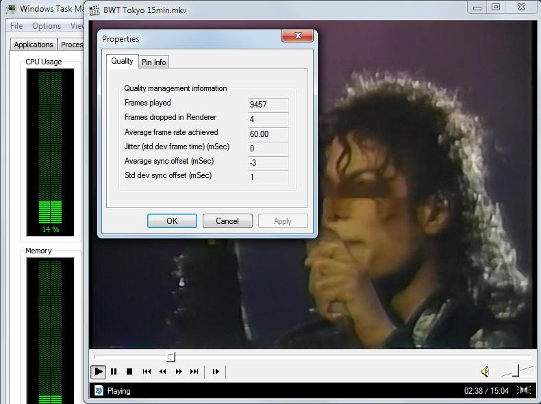

  29. A Core i5 should have no problems playing a 60 fps, standard definition, h.264 video. You probably have a player or DirectShow problem. My Core i5 2500K playing your video with MPCHC and software decoding:
